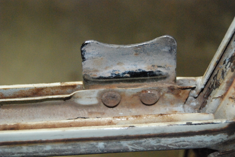

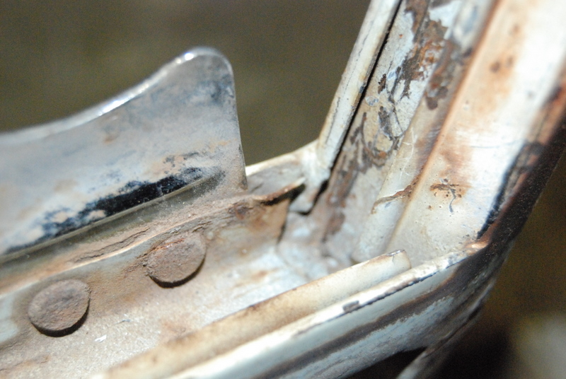

Did you restore your front window frames? WHAT A PROCESS! YIKES! I am going to have them sanded and repainted... but I have a few questions:
I have read and reread all available info of the forum about this subject...
1. How do I remove the riveted latches in pics 4 and 5?
2. How many pieces does the window frame disassemble to? (It kinda looks like another piece is supposed to come out of the vent location of the frame.)
3 How in the world do you slide the surrounding vent window rubber in?
4. I noticed that their are two movebale screw points on each side of the window frame(Picture 2)...won't new paint fuse them stuck??
5. Am I supposed to slide rubber up that shaft in picture 3?

Just done mine so I can give my view on some of the processes;
1. did not do mine,
2. looks like you have all the pieces apart and accounted for - except maybe the vertical bar between the sliding windows or is that laying on the horizontal part? anyway make sure the tabs are on top and bottom of this vertical piece
3. start at the bottom near the pivot and carefully tuck each edge in with a blunt flat blade screwdriver. I started with one side and then used the screwdriver to tuck in the other. No sliding.
4. they will but they'll free off again. Use a tap and I'm sure the process of cleanign the threads will free off the trapped nut plate.
5. Again just tucks in with a screwdriver - I was confused which way round this goes but I'm sure its with the blades towards the glass if that makes sense.
The hardest thing for me was sliding that damn long piece around the outside of the frame - I used plenty of silicone spray and then carefully pushed and pulled around the tight bend with a pair of pliers.
Good luck,
Al

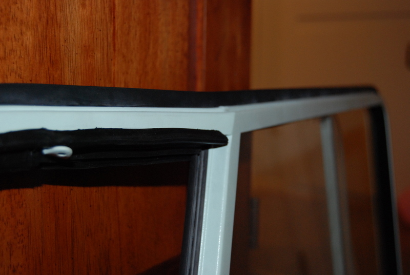

PostPosted: Wed Sep 19, 2007 9:32 am    Post subject: An Update Reply with quote
1 Down...1 to go.

Process: (I'll go into more detail later")
1. Dismantle ONE of your frames. (Use the other as a constructed reference)
2. SandBlast all 5 main parts (Removed latch and latch plate with drill)
3. Lightly Sand then Spray some self-etching primer on the bare metal.
4. Bought some white-blue paintscratch.com spray cans... ($90 bucks & a 3 week fiasco)
5. Spray Painted all parts
6. Sprayed a light clearcoat on top...just because the SS paint I bought wasn't quite shiny enough. ($5 Clear coat from Pep Boys)
7. Riveted a WW new latch and latch plate. (Non-Stock Stainless Steal Pop Rivets. yikes. lol (Rivet Gun and Rivets $25))
8. Installed WW rubber and felt kit. ($90 per frame )(Very Easy to do...took 30 minutes)
9. Placed Windows back in...screw long latch plate and bottom main part in place.
STILL TO DO:
10. Install Vent Glass and Seal.
11. Install Vent Wing Window...
12. Install Onto Bus.
THEN DO IT AGAIN!
