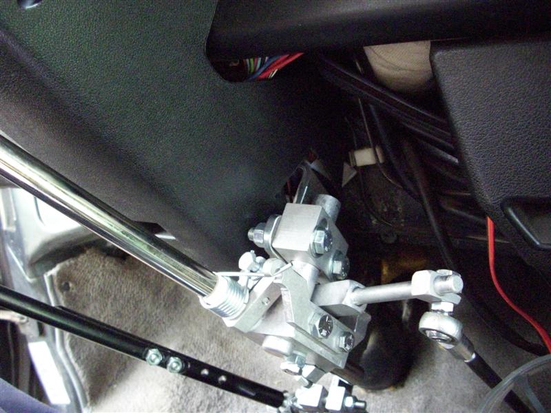

I just finished installing hand controls in my Vanagon. I didn't like the way the universal bracket looked so had a custom bracket fabricated.
The first step is to take a few measurements and sketch the part using CAD.
Then email the drawings over to my uncle's metal fab shop and pick up when it's ready.
Next install the bracket and adjust hand controls to fit.
Standard disclaimer: Only authorized dealers are to install hand controls. No animals were harmed during the installation or fabrication process.

Used hand controls show up on ebay quite often, and the price is reasonable compared to having a new set installed.
I'm still working on the ramp to get in. It's a Westy, and all the lifts I've seen installed in Vanagons do not allow the bed to fold out. Since I installed H&R springs to lower it some, I can transfer from the chair to the seat, but it is still quite a chore.
