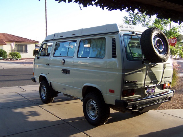

i decided to go back to 16" wheels and tires for that more off-road look.
thought i'd show 'em off

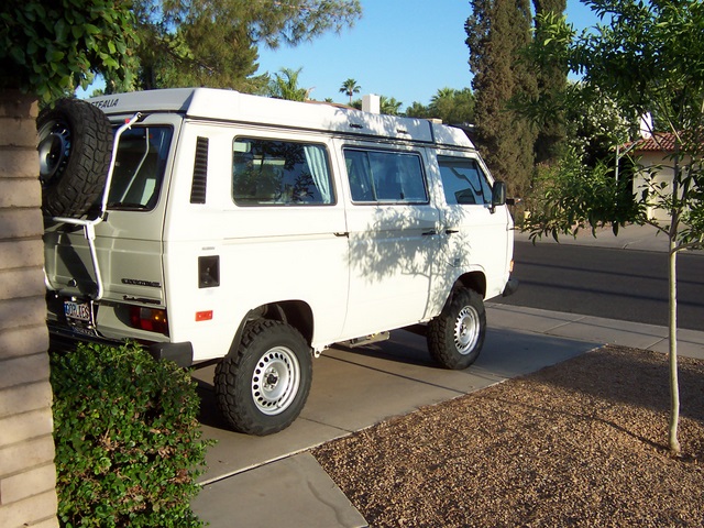

here's more

You have defiantly achieved that 'Gnarly' look. Now you have to come up to Flagstaff to get the dirty look. I like the rack as well.

So......mcsyncro.....made the change?.....well...aaa.....have any plans for the R8s?

Where'd you get 'em? I want some of those on my Tristar. Haven't found anyone who has them in stock.

Oh, and what type and size tires? Did they fit without any mods?
i had these wheels before, got them from mercedes benz. they fit
perfect, no mods what-so-ever. i ordered 5 from the dealer, got
them in 2 days. $335.00 for five.
m/b part number..203 400 03 02
225/75/16 kumho road venture MTKL 71. i like these tires better
than the bfg mud terrains i had on it. they fit ok, but you may have
to slightly grind the inner lip on your rear trailing arm. no fender
clearance problems. oh, also, the wheels are 7'' wide and have
a 37 et.

quick question, did you replace the alu. oil pan with a steel one? I noticed in your post, you were "gettin' after it" this weekend and I am often concern about it with mine. any issues?
i used a 4000 quattro oil pan, the 3b pan is won't work. i have a skid
plate under most of the oil pan, but i've never come close to touching
it. my syncro has at least the same or more rear ground clearance
as it did with the waterboxer.

mellow cat, what motor are putting in your vanagon, a 7A, right?
by the way, you'll need the oil pickup tube for the 4000 oil pan also.
