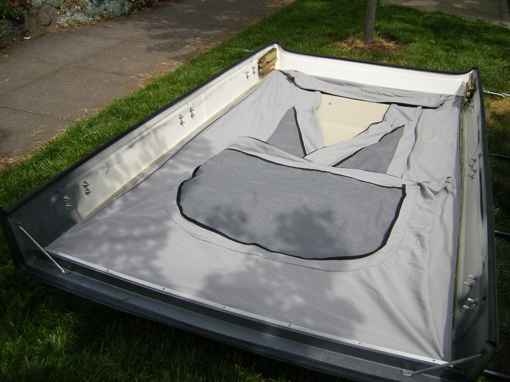

I have an 89 and changed my tent last year. I've done it twice now and I wouldn't do it without removing the top. It's already a back breaker and an arm wrencher. I can't imagine trying to hang the canvas, get it in the right place, and put in all those screws while upside down. I took it off with just one other person.
My recommendation is to remove the top. it will save you at least two hours and a lot of struggle.

Thank you, that's a very useful post. I hope you can add a few pictures of attaching the lower part of the tent!

Unfortunately I didn't take pictures of attaching the lower section. The hardest parts are the back corners where there is limited room. I used a Makita angle drill to reach those screws. Using an awl is useful for poking through the canvas and finding the screw hole in the sheet metal.
Mine didn't have any caulking. I'm not sure it's necessary with the newer style screwed aluminum strips. I didn't use any and i've had no leaking in the wet Northwest.
You can unbolt the top completely then have a neighbor help you take it off. You won't need help again until you have to put it back on a couple hours later. The tent can be put on by yourself.
If you PM me with an email I can send you a few more full size pictures.
Good luck!

Those pics certainly were helpful. But let me get this straight from your last post...you think two people can handle the top, or do I need the 3-4 that GW says? What was your situation with manpower?

I handled it with two people. Start with one outside on the back and one inside. Lift and walk the top towards the back as far as you can go. The inside person can then move outside underneath and then keep walking it straight back off the top. Set it down and flip it over. It can be done from each side but it is much more of a reach. Straight off the back is easier.
Hope that helps. You can PM me with an email and I can send you full size and more pictures.

My canvas was tight after installation. I located the bead just behind the aluminum strip top and bottom and it fit great.
The first time I did it was in the GoWesty Parking lot. I had them install my first tent and that's the approach their installer took. I helped him. The second time I did it on my own using the same technique they used. My gallery has some pictures with the top up. Taking the top off is how GoWesty installs them, not that it's the only way, but I found it easy to duplicate.

When installing the new tent - starting on the top side is a must. Working against gravity will be a little difficult at first, but once you have a few screws in, the job will get easier. If your tent is a tight fit from top to bottom, you definitely don't want to work at stretching it up to the top ... much easier to work down hill.
Silicone caulk was used for the bottom front corners - the tent was so tight that we were unable to get the corners 100% flush to the sheet metal. There was about a 1mm gap ... filled it with clear caulk. Will go back and retry the corners sometime next summer when the tent has more time to stretch.
If you're debating a 1-window vs. 3-window, the 3-window is absolutely the best way to go. This summer we had some hot and humid days while camping at the beach in Santa Barbara. The 3-windows made a huge difference with keeping the interior reasonably cool via excellent ventilation.
In Box me if you have any questions.
Craig
89 Westy

I swapped in a new tent this summer also. My prev experience were 3 window canvas replacements in a 74 Westy and a 78 Westy. For my 89 Vanagon Westy I used a Westfalia make 3 window that is sold by Bus Depot. A nice quality tent much like the original, but with 3 windows. I liked the fact that the canvas was light duty. The aftermarket tops that I put in my Bay campers were heavier grade than the originals they replaced. I figured that if the orig canvas lasted 18 years, another of the same make should be adequate. A downside of the thicker canvas is that the sides are more likely to protrude out from under the top once it is closed up. The Westfalia replacement top also has a removable front screen.
During the process of removing the original canvas I noticed some sealing wax in the angles of the ribs of the metal roof. I replaced this with some "museum wax" to help provide a good seal. I did my whole job in about 3 1/2 hours without removing the top. Like mentioned above, the rear can be easily done with the mattress pulled out. And doing the rear before the front simplifies matters alot. The older stapled type is the same in the older Bay campers and takes a little longer. It helps to warm up the plastic strips with a heat gun or in the oven prior to installing so the the staples go through more easily. Also don't use an Arrow spring stapler, you will need a compressor and air staple gun to get a strong enough grip to hold the canvas on under tension.
