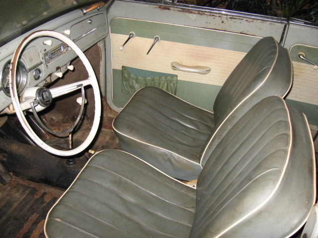

what does the steering wheel look like? do yall have any pictures?
They look the same as the later ones, just the horn ring assembly is different.

PostPosted: Thu Jul 12, 2007 7:30 pm    Post subject: Reply with quote
The horn ring is thinner on '60 and '61 and very susceptible to breaking if you push on the ring too hard. Also, the way the horn ring attaches to the steering wheel and the circuit for the horn relay, as KantDriveFast mentioned. You cant just slap a non-'60 or '61 steering wheel and horn ring on and have the horn work.

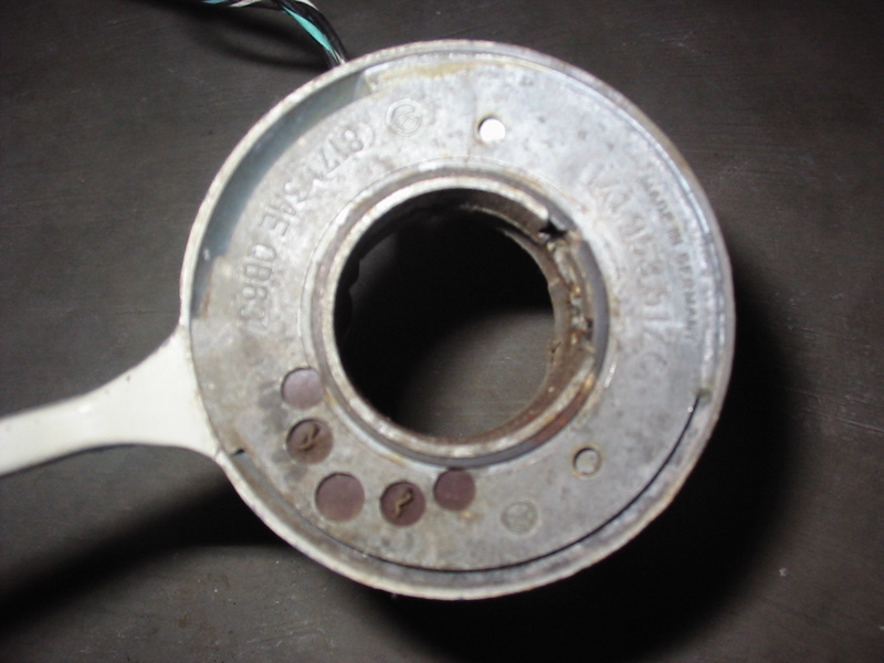

what about the turn signal switch? Isn't it different since it's a semaphore car? I found this swtich in my parts box. It's a three wire, but the part number is a 141XXXXXX, which I believe makes it a ghia switch. Is this one going to work?
