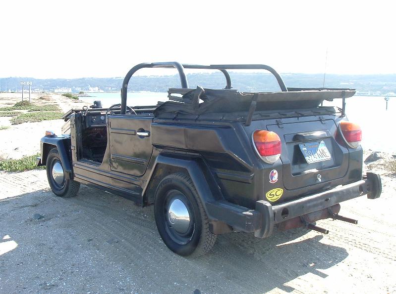

I have the S&S system that exits through the bumper:
I have no idea how it affects performance, but it seems to allow for valve access. I'll find out for sure next week when I take my first shot at adjusting the valves myself.

Keep in mind that many of these systems extend past the bumper. I once had the S&S system on mine, but got rid of it because I didn't like the thought that a tap from behind would ruin my engine or exhaust or both.
The Bugpack one will probably also extend past the bumper.

Would the bumper overrides from The Thing Shop be able to protect the exhaust & engine much from a "li'l love tap" from the rear?
--- EDIT ---
Okay, I lied: it doesn't look like The Thing Shop carries them anymore. Y'all know what I'm talking about, though.

Good point, Ian. There is that risk, but maybe since the pipes are already bent, they would deform before doing much damage to the engine?
I'm running a Beetle muffler with peashooters right now, and that's surely more of a hazard to my engine than any of the above!

I used to have the same narrow bumper overriders shown in the pic above, and the S&S reached farther back than they did. Maybe the block style ones would do it.
