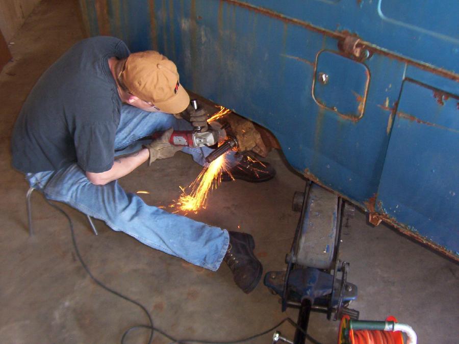

After spending two days pounding, torching, prying, cursing and accidentally slicing my thumb, I enlisted one of my trusty friends with an angle grinder & cut off wheel to cut the sucker off.
