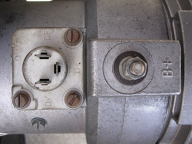

I have totally restored my 69 bus everything and done it ALL myself. Just never been good with the Electric part of it, But did it. Having a few problems.
2nd battery on 2nd alternator not charging.
Belt turns no slipping.
4 spots on the back of Alt. for wires. big post for wire going to battery.
and 3 other wires, one red one, a brown one, one brown with white stripe.
Labeled
post B
small red wire S
brown wire F
and brown w/ white stripe is L
besides the post wire going to the battery where do the other 3 wires go?
I have nothing going to the red or the brown w/ white stripe wires and the other brown wire is hooked to a L.E.D light going to the coil hooked to the neg.- side with the condensor and the other green wires.
Battery not charging are all the wires hooked up correct?

Sounds like you have a Motorola alternator from a bug??
If yes, you need the harness AND voltage regulator from the bug it came out of.
http://www.oldvolkshome.com/7374altvr.pdf
Here is the top of the Motorola alternator w/external regulator:
Does your alternator resemble this?
