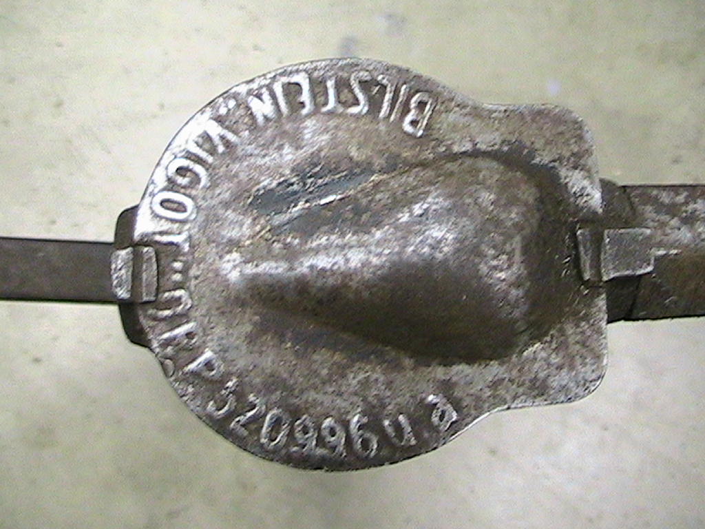

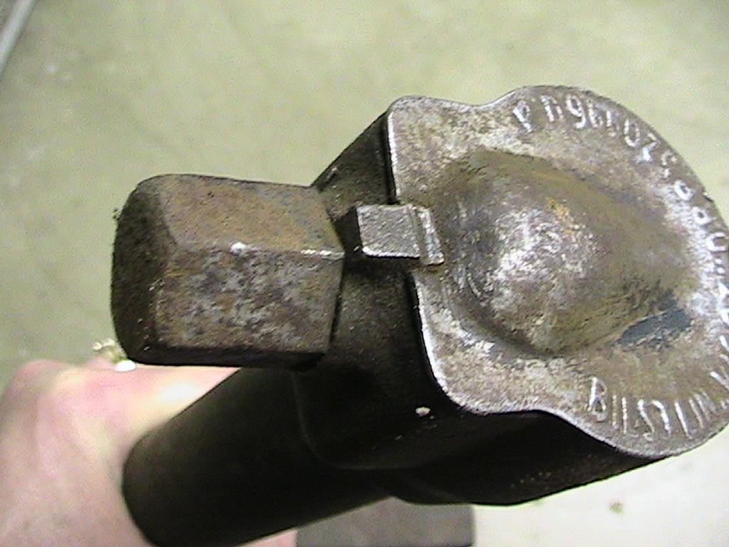

PostPosted: Sat Nov 21, 2009 4:53 pm    Post subject: Reply with quote
Can somone comment on what this jack is for? Could it be correct for an early (post 1948) split?

PostPosted: Sat Nov 21, 2009 10:38 pm    Post subject: Reply with quote
Can anyone offer help on my pictures above?

PostPosted: Sat Nov 21, 2009 10:55 pm    Post subject: Reply with quote
Thorsten ,
I think your jack is correct 49 /50 beetle's !
