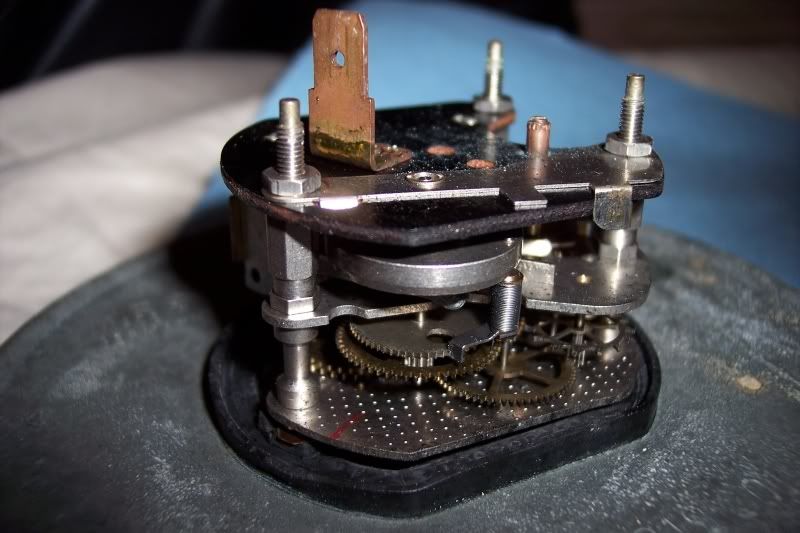

I wrote the original 12v repair that is posted here.
The mechanism of the earlier clock is quite similar to the 12v model, it's just in a different case.
After not working and sitting idle, they almost always need a shot of some light penetrating oil. I have some aerosol gun oil which is very light, I spray the mechanism, than immediately blow it off with compressed air - make sure you have a water filter on the compressor, or you will just make a mess.
The fuseable link is a little brass tab with a bend in it near the top, there is a little hole in this tab. Once you will find this you will see where to push it to create the electrical connection - solder should flow through the hole on the tab to create the best connection.
I will post some pics to update the clock repair section.

I took the clock out and sure enough the fuseable link was broken.
Mine is a 3/58 VDO and the soldering repair is very simple. Put it all back into the car and low and behold...still not working Embarassed
I'll take it out again tomorrow and give it an oiling. Rolling Eyes
John.

PostPosted: Fri Oct 19, 2007 10:18 am    Post subject: Reply with quote
Give it some oil. Most of the time they have been sitting idle in less than favorable conditions - for a mechanical clock.
Look for the contacts that make the clock wind. You can manually wind it and watch to see if it is working before you put it all back together Smile
Of the dozens I have repaired, I have only seen one that was truly "worn out"

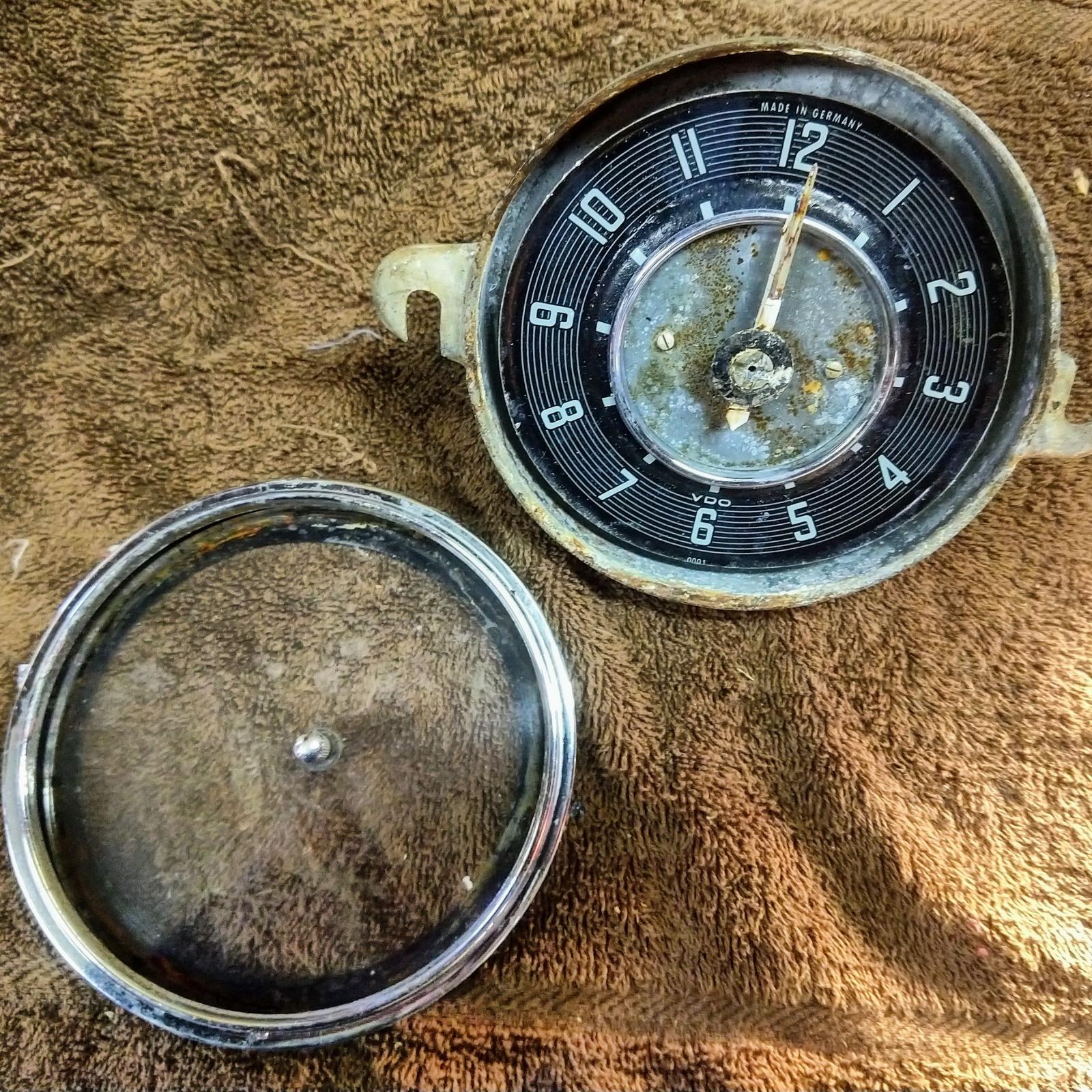

I dug out the original clock for my '64 Ghia 'vert. I'm trying to decide what to do with it. Unfortunately, it has suffered some water damage over the years:
Is is too far gone to bother with? Are there rebuilders who could use it for parts?
Does anyone have any tricks for fixing up the face, like printing something out at Kinko's and gluing it in place?
