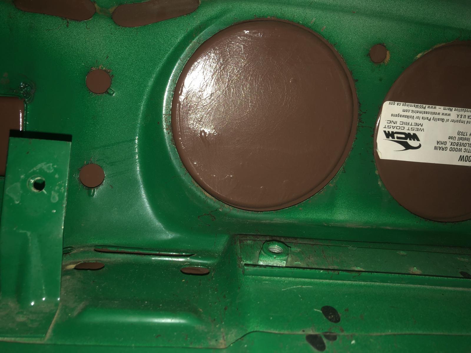

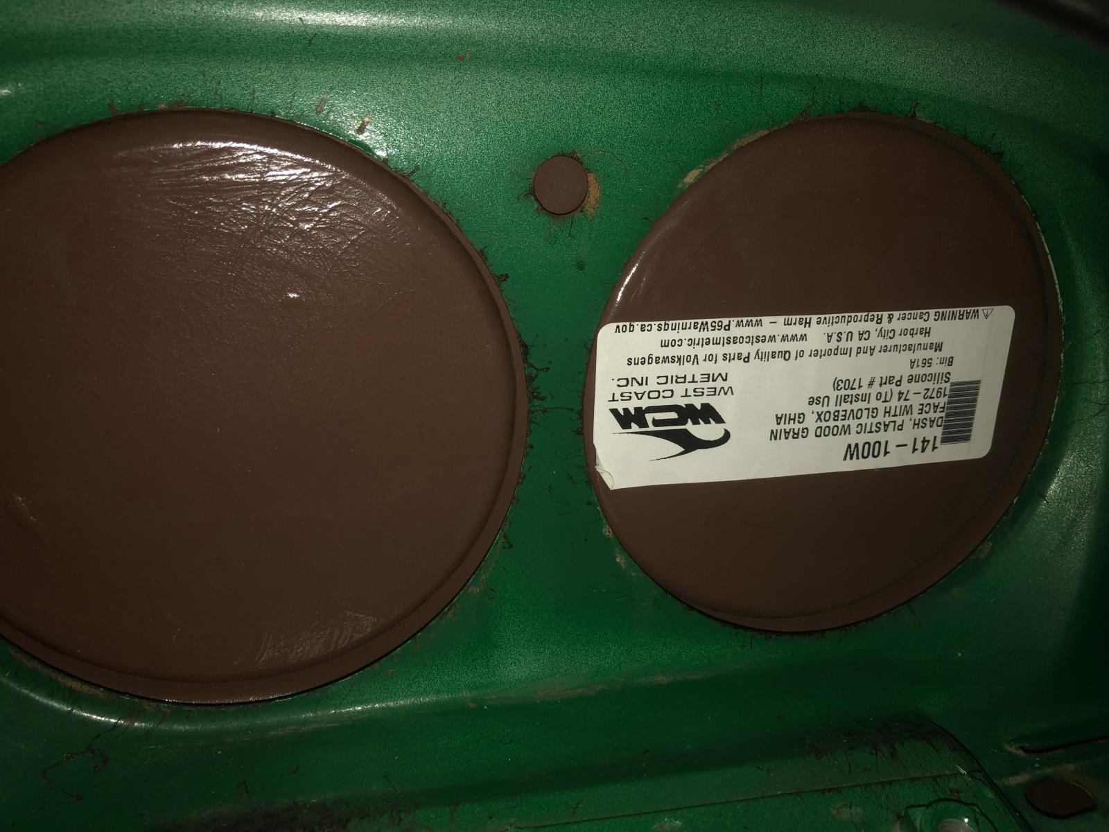

Has anyone had any problems with the West Coast Metric wood grain dash covers fitting poorly. I have a ‘74 with an unmolested dash that’s getting one. It fits the gauge holes and speaker cutout fine, as well as the radio hole, but the glove box cutout is about 1/8” too narrow. I’ve called WCM and KGPR and both say no problems with the dash cover. Ordered a second one and better, but still off at the glove box. Also, a bit concerned about the amount of dust on the new part after WCM telling me they’ve sold over 100 with no complaints. Am I missing something? Do I need to heat it up in the sun? At a loss…..
Any help/thoughts would be appreciated.

too narrow? Meaning the molded indentation in the woodgrain-plastic cover is smaller than the opening in the dashboard in general? I suppose, maybe.
I made some relief-cuts and (using a heat gun and heavy gloves) heat-formed the plastic, folding it back on itself through the dash opening. I just assumed that this was how it was meant to be installed. Same for the woodgrain cover of the glovebox lid... heatformed around the edges of the metal part.

The distance from the other openings to the glove box opening mold. I have some pictures. These are with the glove box aligned properly. The dash cover shifts on the pod opening. I might try some mild heat with a heat gun.
