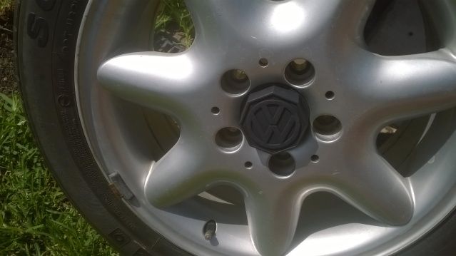

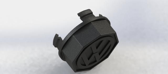

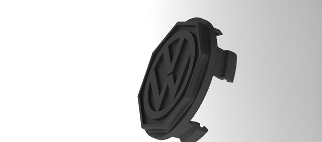

Hi guys, thought I would add a little something I have been working on.
A center cap for Mercedes wheels to clear the big grease cap,
Before you go and jump up and down screaming YIPPEE!! This is designed to fit on most merc rims that are available in Australia, to that end I have never been able to lay my eyes on a set of CLK rims here and I can not tell you whether these will fit. If someone would be so kind as to send me a photo of what the CLK cap and its clips look like I maybe able to shed some light on that though.
The great thing about these caps is that you can actually use the spring clip that cam with the original caps for a very nice secure fit ( in theory anyways, the first set is due in a week and a bit) They can also be printed in a range of coloured ABS and you boys in the states can even order them though Shapeways if you so choose. Being a computer file it can be easily changed and the logo on the top can be anything you can send me a decent picture of, at this point I am happy to simple designs at no cost.
Now...... down sides, they are plastic and being 3d printed are dear. At over $100 a set you will have to have run out of options. Also, technically I can not sell VW badged caps for licencing reasons (i'm still looking into the details on this, anyone who has experience with this kind of thing please shed some light) I can only offer a blank cap with a 56mm recess that will except most of the coloured stick ons you find on Ebay.
Though... . . .I am happy to do custom logos at peoples requests, so if you were to request a VW logo, well i'm in the clear. you just can't get them though Shapeways that way at the moment.
Anyways, enough jabbering. Any questions/suggestions feel free.

The day has come and I have something tangible in my hands! Very Happy
After reading this thread again I noticed I never mentioned that these are for Mercedes alloy rims, to replace the little star cap in the middle. Best indications are that they WILL fit the CLK rims, somebody on here is to confirm that for me very soon.
I have also been contacted by quite a few fellows here and in the states in regards to custom LOGOs and sizes. So far a have a
+3mm cap - probably only work if you have a big arse brake conversion on your van.
+10mm cap - this is what most vanagons, er.... think I have T3/25 will require. ( think I have answered alot of US emails this week) and
the +20mm cap - this will be required depending on what alloy or grease cap you have, I think bay windows have a longer cap?
The BIG bonus to the shorter caps is that the shorter they are the less they cost to print.
What I did forget to mention earlier is that you HAVE TO have the spring clips from the original caps!
I have also been ask to do a set with the PUCH logo on them for the syncro guys, so someone will be rolling around with these soon.
