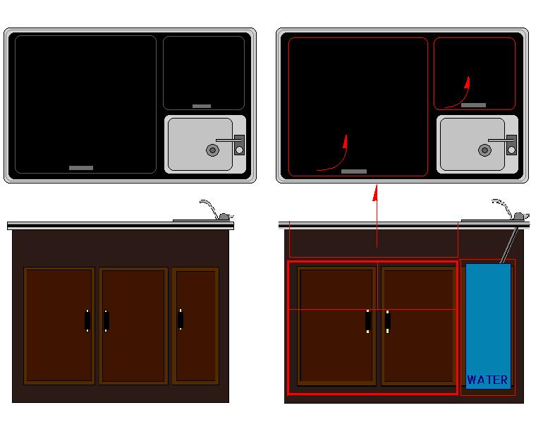

I've been wanting to pull the sink unit out of the weekender for a while now, but havent come up with any way to do it without the new storage unit segwaying to other stuff, like the headliner and exterior, so I was thinking about trying to duplicate the materials in there now ( black 60's formica top with some sort of darker wood grain veneer on the cabinets) just in a different style. I'd like to keep the sinks aesthetic (is it anything more), but it seems stupid to have a un-functional sink there.
I've never used the thing so im not quite sure how its supposed to work. Is that drum below the cabinet supposed to be pressurized some how?
Thought that I could buy a large litre plastic container and run some tubing up to the sink. If it needed pressure maybe fit a bicycle pump into the side of the container.
-the units on the top flip up, underneath would be 6 inch deep trays to hold electronics, books and such. Would probably install two cabinet locks on these.

Either an electric pump (demand or manually switched) or air pressure in the tank (tire stem or small compressor) Kinda like the window squirter.
