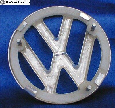

If your '61 was built in '60, it originally had the 4-tab VW emblem on the hood. If it was built in '61, it had the early 3-pin emblem, only used with the Wolfsburg crest.

FYI, it was at chassis number 3551045 when the change to the 3-pin hood happened.

Um so 1958 not 1960... always wondered why my 61 had only 3 tabs. Cool

july 31,1960 3 204 566 august 31,1960 3 267 185 ... october 1960 was change from 4 tab to 61-oct 62 pin with crest. 61,62 and early 63 had goofy plastic 3 pin emblem.
Are you saying October 1960 was the last of the four tab emblem mounting arrangement? I thought P/R listed that change as Jan 2, 1961...?

july 31,1960 3 204 566 august 31,1960 3 267 185 ... october1960 was change from 4 tab to 61-oct 62 pin with crest. 61,62 and early 63 had goofy plastic 3 pin emblem.
1 October 1962 5 010 448 (113-118) front hood : now:vw sign redesigned formerly coat of arms--- now : trim moulding lengthened page A-205 progressive refinements 2 manual number 530 210 20 with 17 supplements added(17th supp. dated 4/67..... which page number in progressive refinements did you find jan 2,1961? jan 2.1961 would be 1962 model year.

January 1961 was still the 1961 model year....
He's talking about the entry on page A-55

This is the correct emblem for 61 right?
