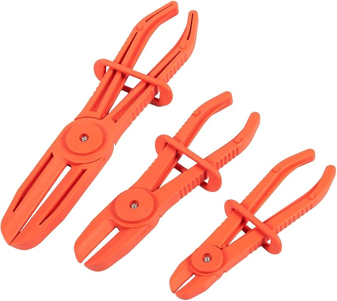

A simple hose clamp pliers will also block coolant flow to the heater core. There are dozens of ways to skin this cat.
