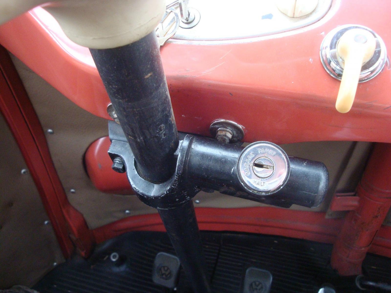

My '55 from a few years ago. This could be the wrong one but it bolts up to the column:

the factory photo appears to be a 53 ? early speedo, double fuse box, no indentation on the lower speedo pod edge. Probably the bolt holes for the og column mount clamp have been touched up, as usual with factory manual pics.
BTW what key style does this lock use, and is there a key# on the cyl anywhere? Mine is missing the key unfortunately. It's an early fat column.
