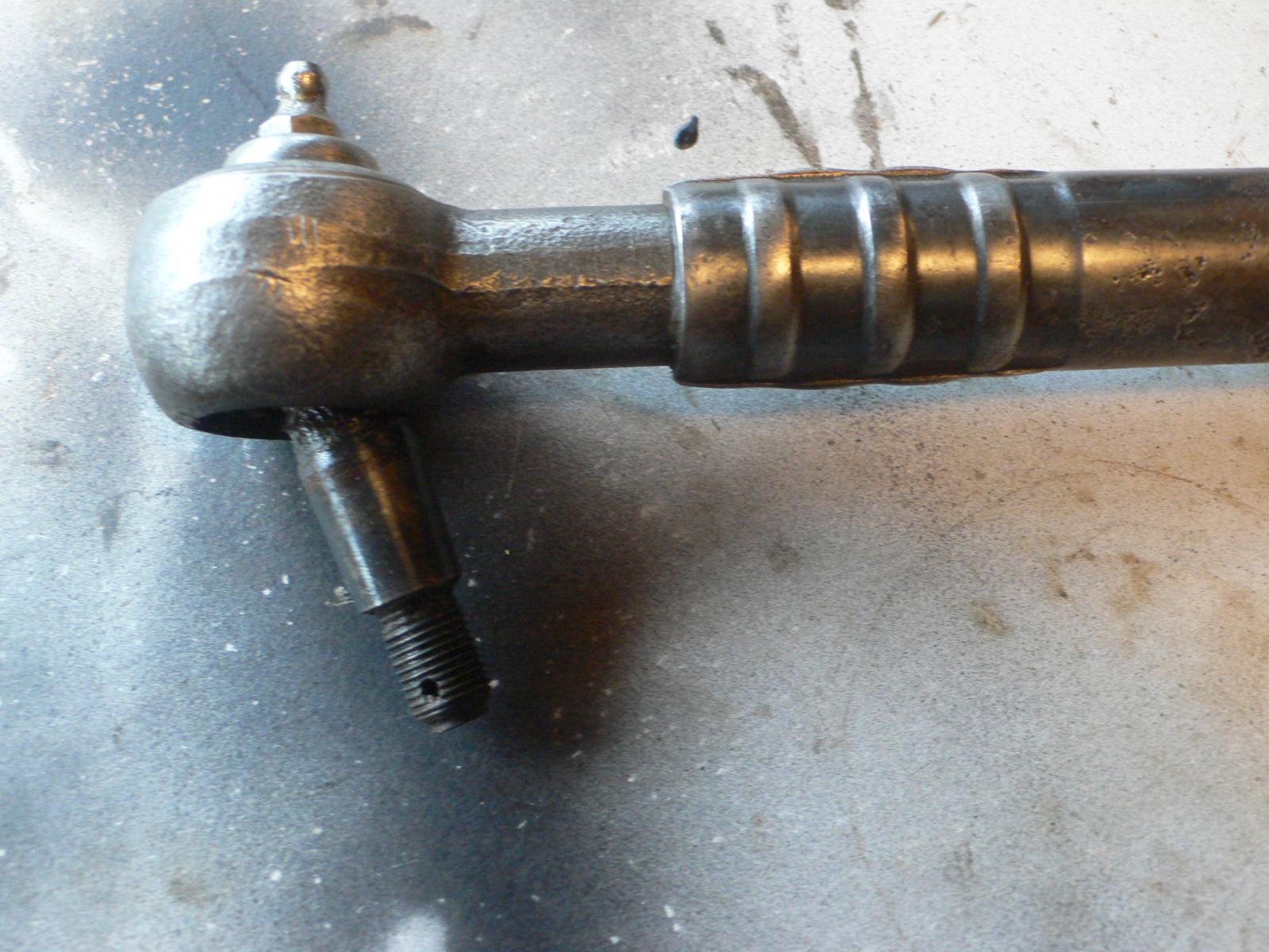

I am looking to replace the short tie rod on a 54 LHD beam.
Has anybody repaired these in any way or found an alternative that looks the same rather than using a later style?

I have done this on a similar German Ford tierod (discontinued). you need to cut open the pressed part at 180° and peel them slightly open with a chisel, until you can remove the old rippled balljoint. then I brought it back to the og cylindrical shape and put 2 spot welds on the open slot ends.
Then I cut new threads inside according to the new tie rod end. clean off the lube and assemble with thread lock to correct length (take thorough measurement of length and degreeing before disassembly). Only then I clean the slots and fill weld the slots solid. I do not really weld the tubing to the threaded tie rod end, but just try to hot weld the tubing.the welds will shrink and further fasten the new tie rod end.
In addition you can grind grooves as seen in the pic, where you hammer the tubing down into for even further strength.
Working on steering parts is always delicate, but I believe there is 300% saftey in my procedure. Driven it over 10k miles, and I do hard cornering. all well. Very Happy
Once painted, nearly undetectable. Good Luck !

Thanks for the reply Guenter... That is what i was thinking of doing if i can't find an easier way. Good to see the removed tie rod end to see what it looks like... But i would still have to use the open style tie rod ends with separate rubber and grease nipple to look correct! So need to find a source.

Simon, I thought you were going to use the one pictured in the photo.
Some time ago there were several NOS tie rod ends available in the TS classifieds. in keeping with the og looks you could put a thin walled tubing sleeve over the remaining threads. to achieve the shouldered look of the pressed rod end.
