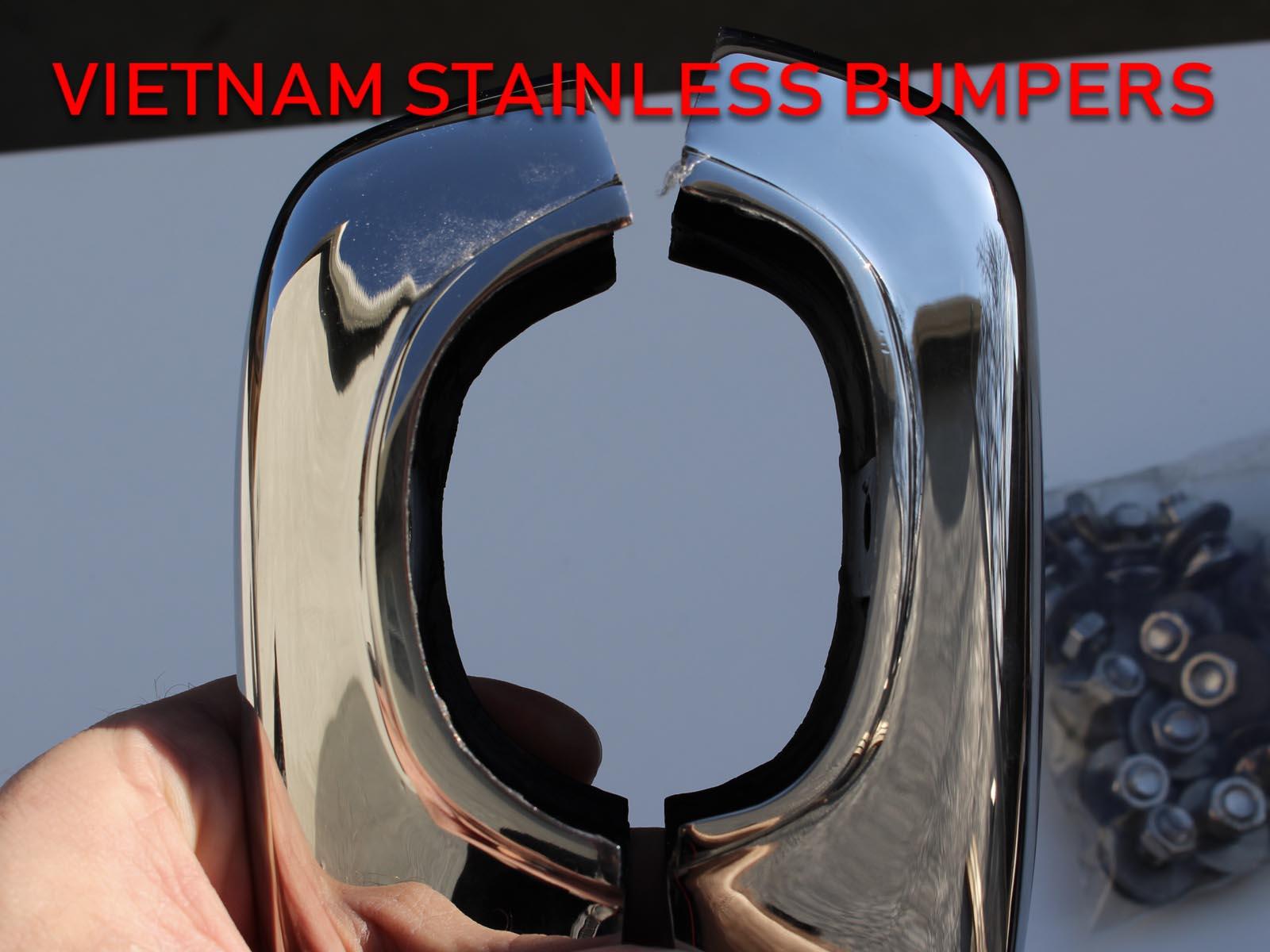

Lets look at the bumper shape now. Split bumpers SHOULD use the same overriders front, back, left, and right. These have different guards for front and back. At this point it's obvious these bumpers are shaped like later bumpers that have had a rib (poorly) hammered into them.
different guard profiles for front and back. Not "comparable to original" at all.
nice lopsided shapes to some of the guards!

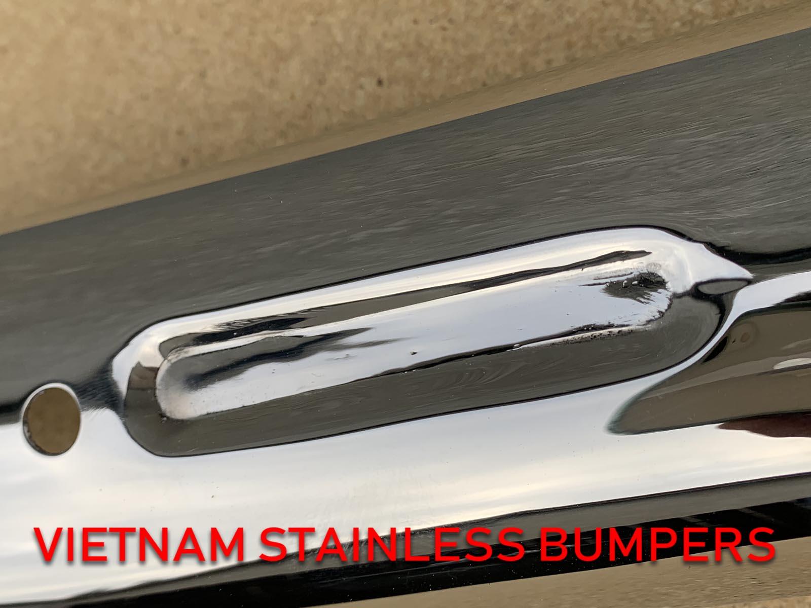

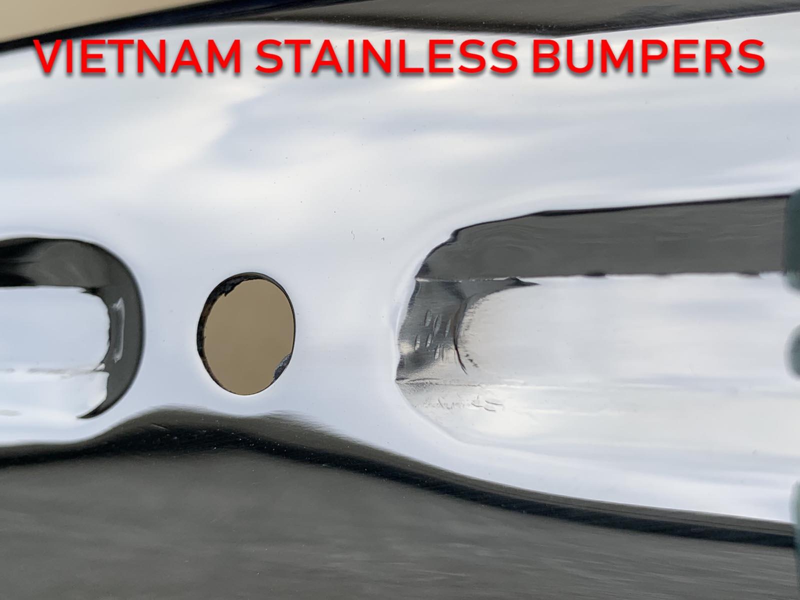

Arrow Now lets look at the ribs hammered into these shiny bumpers. That should be fun.
That's an interesting shape!
Oops! Hammer must have slipped
Sure, that's round Rolling Eyes
Ah don't bother trying to work those die lines out. Every freakin rib has these lines through the ends. They're hard to see in pics, but this one shows them pretty well.
Oh that's great

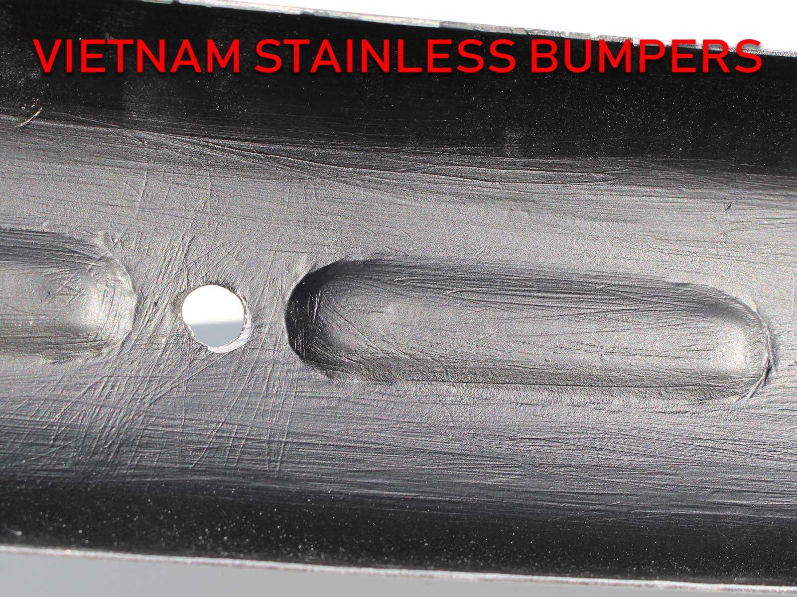

Arrow Lets take a look at the back now! You might wanna sit down for this one...
You know how Beetle bumpers don't tuck up against the body so you can see the backs of them when walking around the car? Well feast your eyes on this:
Yep, the entire back of the bumper looks like that. Remember in the ad when they claimed to add 3 layers of paint so the backs would be more "smooth and beautiful"? Laughing Good thing there are 3 layers of paint, or else this might look like crap. Rolling Eyes
visible welds. yay.
beautiful.

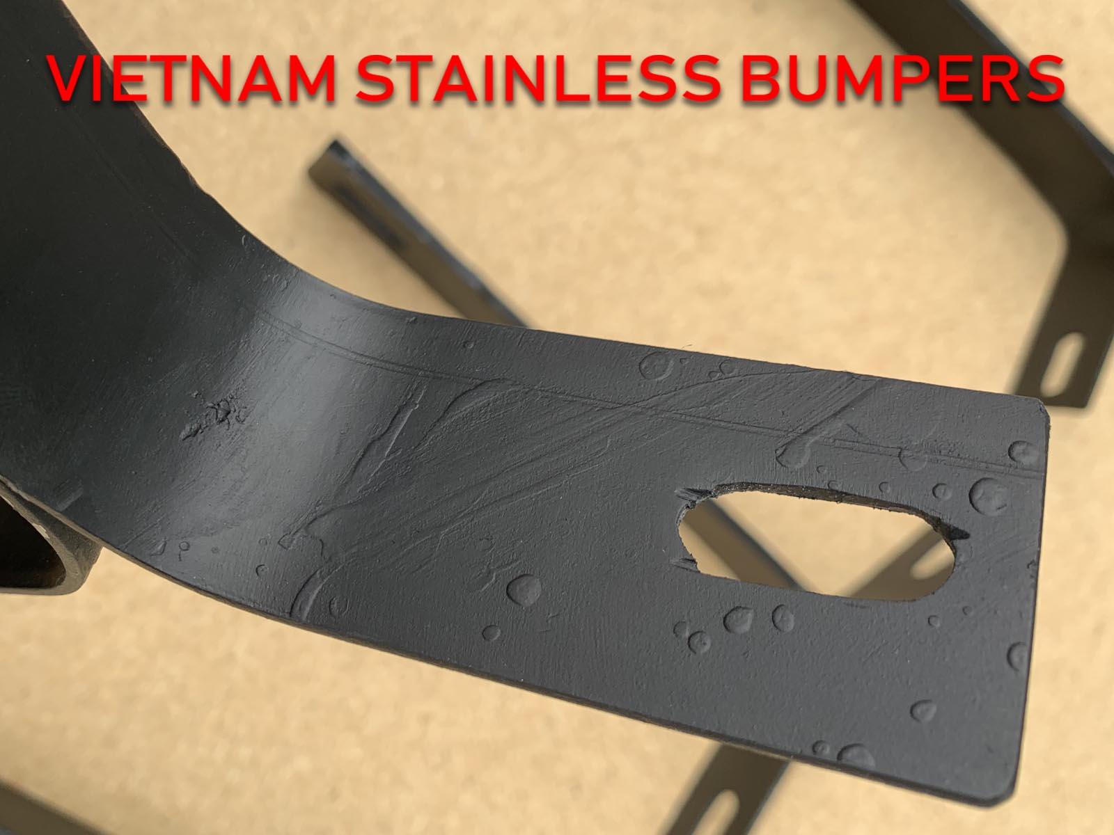

Arrow Since we made it this far, lets take a look at the brackets. They're just brackets, pretty hard to screw up right?
Oh... ok. Yeah, those are trash. Cutting slots in the brackets with a cut off wheel, that's odd. Looks like 3 more layers of beautiful paint on these too.
Well I'm sure they are at least shaped correctly, right?
No... all 4 are different shapes.
tack welded across the tops. Rolling Eyes
This one is my favorite. Very Jackson Pollock.
They would be better off not including brackets at all.
