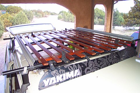

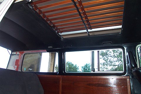

Well....mine kinda is a "rag-top". I used the frame from a taneau cover from a pick up truck. The side rails have a sliding track for the snaps and three removeable supports that I shortened and reshaped. I bought new material and custom shaped my new cover. the picks below are old but you can see the frame sort of. I did this to have the largest opening possible. (and I'm an artist Laughing ) I could have picked any color for the cover. I went with the trusty old black.
You can see the tape in the corners when I was fabricating this.

Van-Go108, more is better.

Thanks for all of the info! Van-go I doubt that I have your fabrication skills, but it does look killer! I followed the other link, thanks for providing it, and hope to hear more about the Streetbeats kit.

Uh...Thanks?
They first time I attempted this was on a 68' Ford wagon. I cut it open from the front window to the back. I learned a lot from that. It seems that one continueous role of canvas shrunk way more from front to back rather than side to side. I was going to cut the vans complete top out. I planned on seeming three square sections to help control the expansion and contraction. After seeing the structure of the van I decided a single square opening was better and simpler.
I knew that replacement tarp would be a bit difficult to replace. (I.E. The streetbeat kit, which I almost bought.) I opted for my method because I could always make a new one myself cheaply. The snaps press in and edging off the tarp is easy. If you have the right sewing machine, of course. I like being able to take the whole tarp off and stashin' it in the back. In the high winds, it is planted solid too.
I remember that forum on the streetbeat kit. I do like it. $600 is not bad but I spent under $50. Cool well, not including beer. I'm trying to save my money for a 10 cent motor anyway.

$50 plus beer?
Any more detailed pics of the snap system and the rails?
You've appealed to my cheap side!
