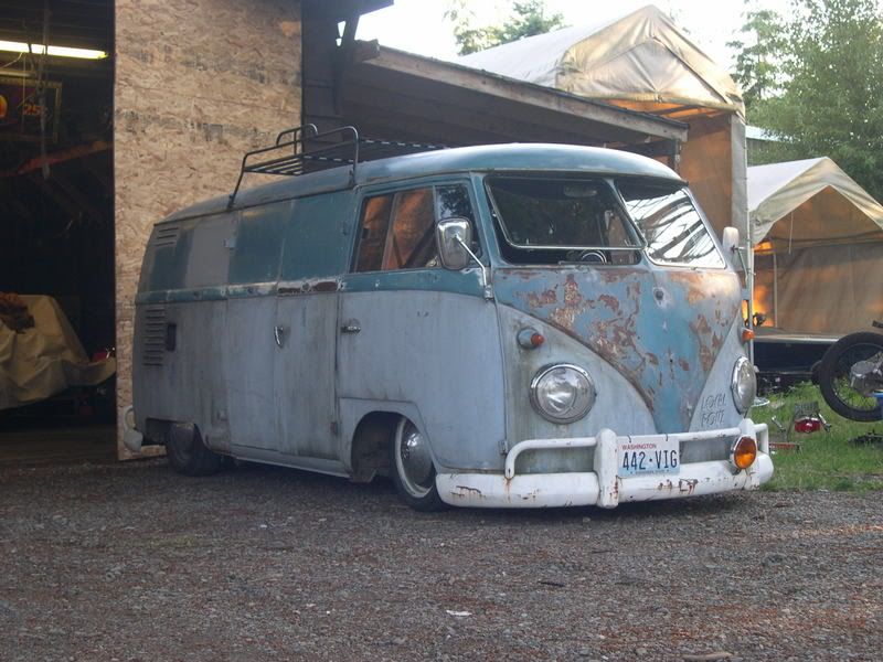

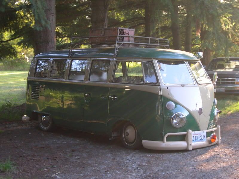

195/45/14 is the way to go, smallest wide tire you can get for 14 inch bus rims. i have them and love them. they are Toyo Proxes series

PostPosted: Tue Oct 16, 2007 10:34 pm    Post subject: Reply with quote
theyre only for super low buses.
here are some on my buddy's bus
this bus has them as well
