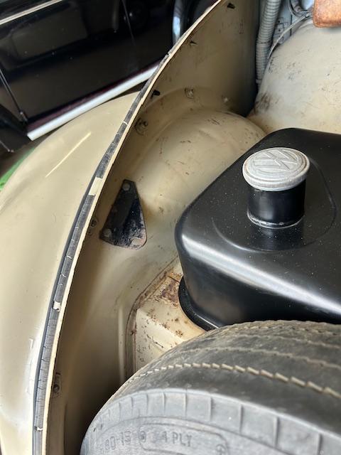

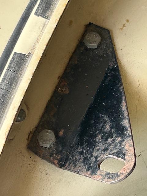

Here is a part fastened to the front, right, bender with what appears to be original VW bolts. I need help figuring out what it is for..The hole is too small for the jack handle to fit through.

Guessing...
It looks like it could be to tie/chain the jack onto, to hold it in place.

PostPosted: Sat Jul 26, 2025 11:31 am    Post subject: Re: help with mystery part Reply with quote
something like that is what came to my mind as some early cars had a place to lock down the spare tire with a short chain ........i have looked on my 51 bug and i dont see the lock tab but i see it for sale here , this is what made me go look at my bug for one .
https://www.ebay.com/itm/285891820045
here is a Samba thread showing the same part installed in a bug and its intended use .
https://www.thesamba.com/vw/forum/viewtopic.php?t=493292&view=next
another thread showing the Burg lock and explains if you install the spare backwards in the trunk you dont need a chain just the padlock .
https://www.thesamba.com/vw/forum/viewtopic.php?t=...p;start=40
Pardon me if this seems "dense", but aren't these very different parts?
Likely related, though NOT the same? {mounting in separate locations)Question Question

PostPosted: Sat Jul 26, 2025 7:29 pm    Post subject: Re: help with mystery part Reply with quote
it is just a conversation looking for more / better info ? is how i see it ? what are you thinking ? the OP part looks worn like something went thru that hole ?
so what does a jack look like installed there , does anything line up ?
