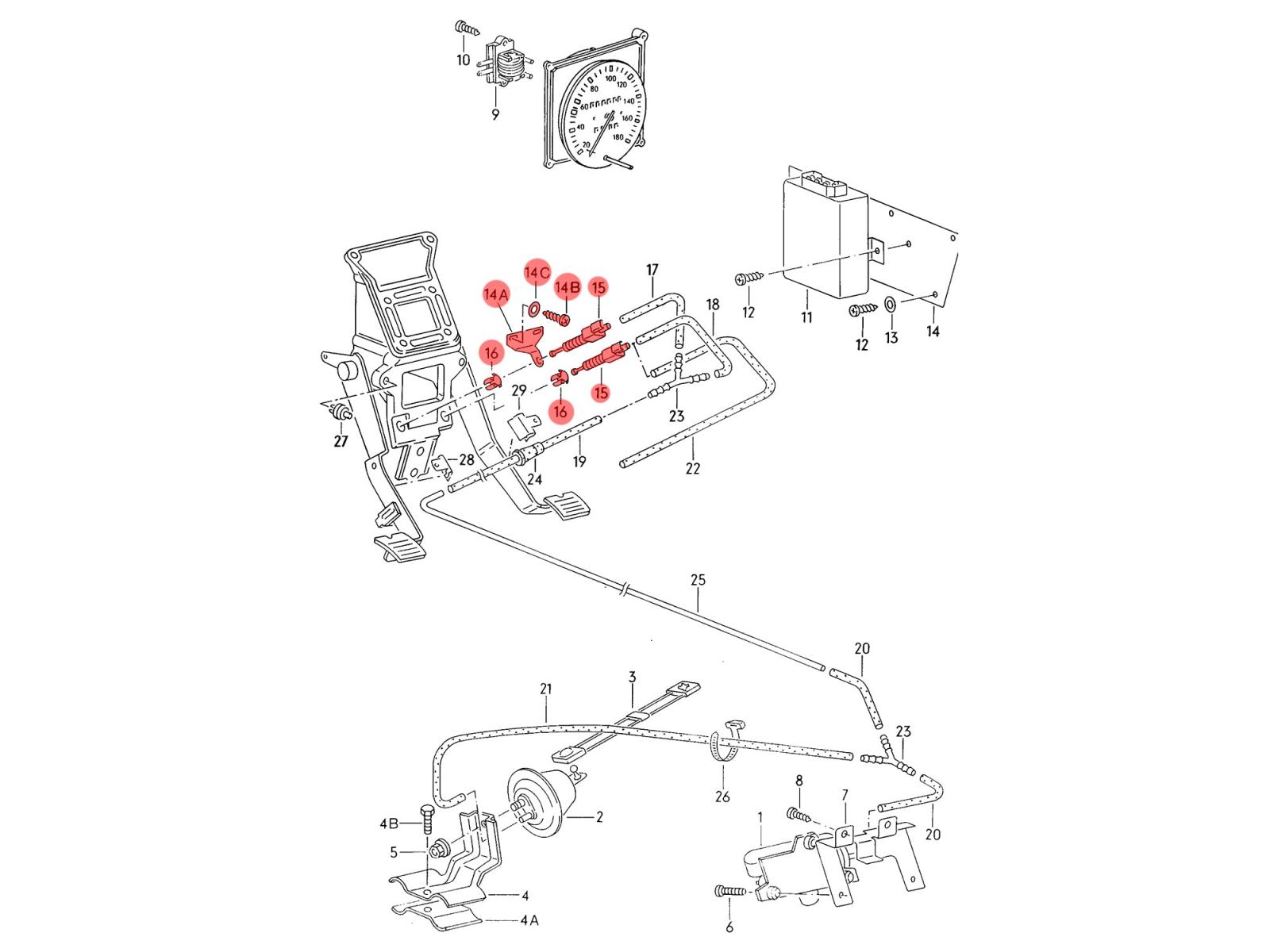

I am pleased to report that Scarlett still has a working factory cruise control! Well, until yesterday. The small clip on the brake (or clutch) pedal arm that pushes against the plunger of the CC switch broke. Anyone have one in their parts bin they are willing to share? Not looking to replace the whole switch with the GoWesty offering (at least not yet). Part 29 in the diagram below.

FYI, I know you are not interested, but I replaced mine with the Gowesty switch. It took less than an hour and I am slow at such things. Works perfectly.

Thanks! Glad it worked well for you. I know it replaces the electric operation of the original factory switch. What did you do with the associated vacuum tubing? Also, a functioning original switch is almost unobtainium. Did you sell yours?

The Gowesty kit eliminates the vacuum line the goes to the front of the van completely. I kept the original switch in a spare parts bin just in case, but it didn't function anyways. On the diagram, the hose #21 just goes from the pump directly to the diaphragm now (#23, 20, 25 eliminated)
Dropped from the VW parts bin in 2007... not available new unfortunately.
I can't find a picture of it, but perhaps you could fabricate something similar? Kind of like what's shown on this page (albeit for a Subaru conversion): http://subaruvanagon.com/tom/Cruise%20Control.htm (just realized, it's Tom Shiels' site!).

This “H-shaped” part sits over the brake pedal arm like a saddle. One leg broke off but I might be able to effect a repair.

My brake switch vacuum section failed. I just plugged the tube that runs up front at the tee in the engine bay near the vacuum pump.
Electrical part remains working fine for me

Dumping the cruise vacuum at the clutch or brake pedal was a quicker way to release the throttle and a fail safe if the electronics failed to slow the engine.
Seems a simple tab could be added to the pedal above to operate the switch. It could be bolted or welded.

Successfully created a replacement right-angled tab from another (non-Vanagon) project. Used a 3M double-sided pad to adhere the L-shaped part to side of the brake pedal arm. Then added a large spring clip on the bottom side of the arm for additional strength. Trying to drill into the cast arm seemed a fool’s errand.

Glad you sorted it. If the adhesive doesn’t hold up, I’m pretty sure the pedal is mild steel and fairly easy to drill. Do an 1/8” pilot hole with a sharp bit and follow up with the bit that matches your fastener. Thanks for reporting back. As time goes on, we need to get more innovative when parts are NLA. Maybe post up a picture of your fix for others.
