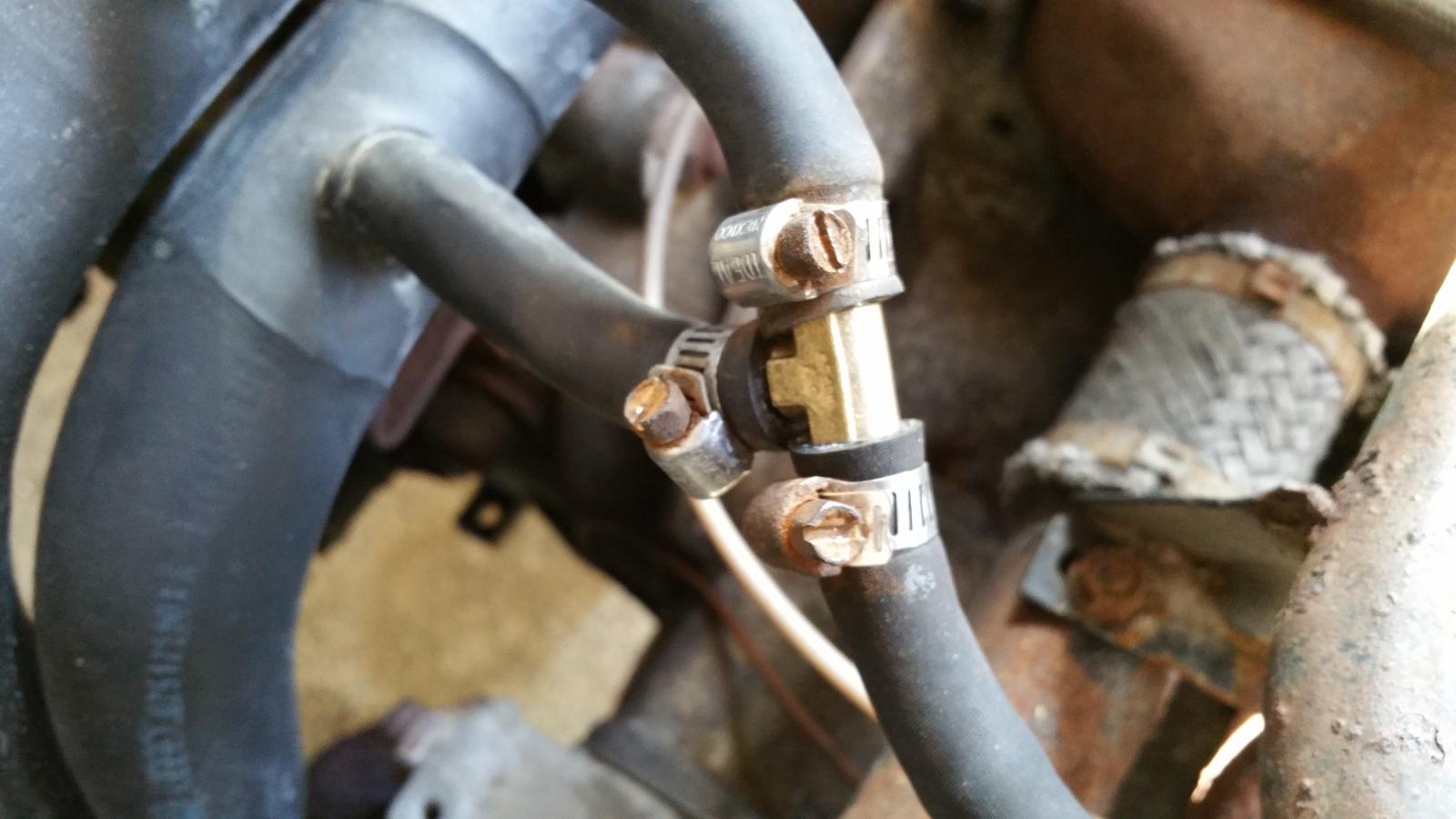

So...after this bleeder valve crumbling leaving me on the side of the road...I temporarily MacGyvered with a pen and a screw driver clamped inside the hose...leaving top tube sealed.
So...I have since went to Home Depot and found a T that fit well and I just won't have a bleeder valve anymore.

Here is the fix
..let me know if this is bad for her?

PostPosted: Wed Feb 28, 2018 7:21 pm    Post subject: Re: NEED '83 Westy bleeder valve part # 025 121 421 A Reply with quote
Just broke this part. Woo. Anyone have any problem with the above fix?

PostPosted: Thu Mar 01, 2018 8:26 am    Post subject: Re: NEED '83 Westy bleeder valve part # 025 121 421 A Reply with quote
I would have sprung for new hose clamps. I don't see a problem with the above repair, but you are losing one place to bleed out air that might complicate bleeding the entire system. I believe you posted in another thread and I assumed you broke the radiator bleed. The bleeder repair kit I suggested could be utilized with the above repair.
