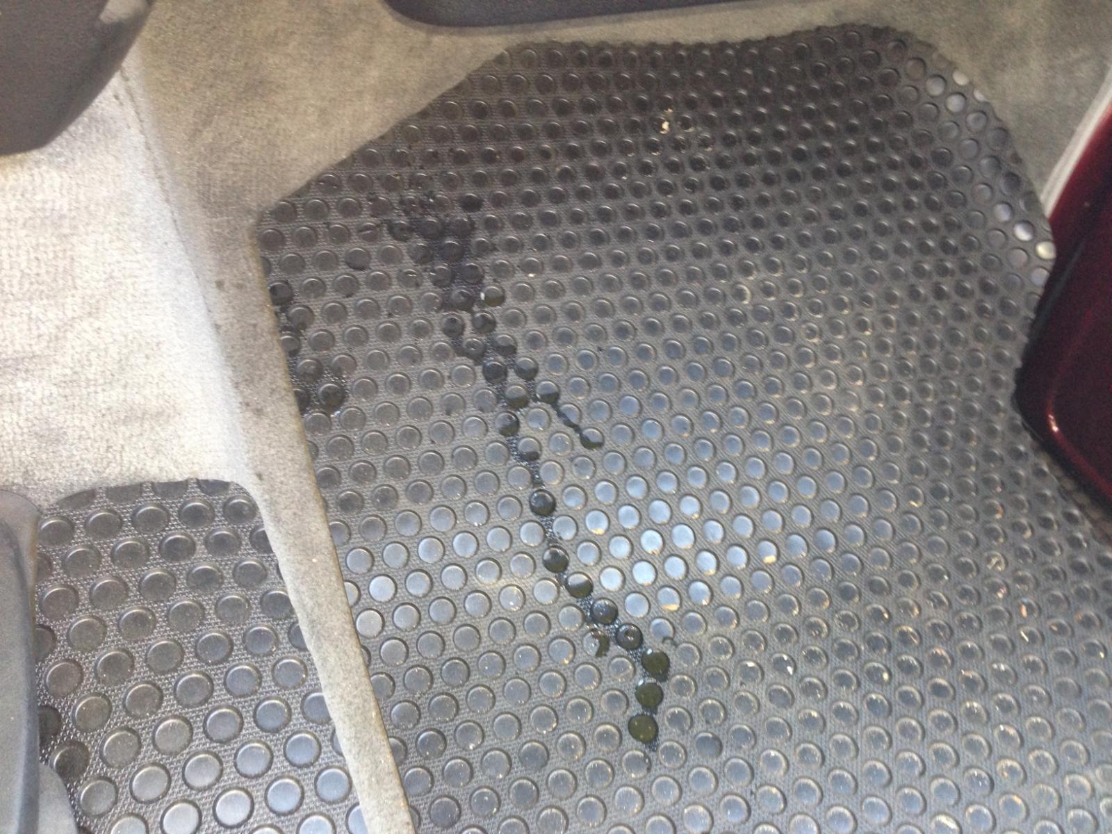

I just went through the car wash. The usual catching water through the skylight happened.
But this time, it also was leaking under the passenger seat. Has this happened to anyone else?

Yes, mine ended up being the antenna base leaking. Other possibilities include, window seal, wiper posts, and bad seam sealer.
Might need time to do some testing with the garden hose. Very Happy
Edit: I see that's your passenger side. Is that coolant? If its coolant you have a leak near your heater core, maybe at your heater valve.

if it is water my bet is that the water is getting through the wiper arm pivot - where else could it be from at that location?
Are you sure it's not coolant?
