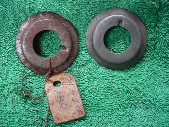

lemon juice contains citric acid which is mild and yes, it does remove rust without serious metal damage. if you buy some in the store, get as pure juice as you can, as some is slightly watered down.
you just need to be patient, as it is a slow working process.
before on left, after a couple days in lemon juice on the right.
you might also try a product called evaporust, although you usually need to buy it in 5 gallon containers.
