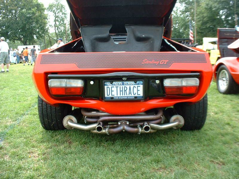

PostPosted: Tue Jan 19, 2010 8:10 pm    Post subject: Reply with quote
This set up (On my Sterling Kit car) kind of sounds like an old Porsche:
