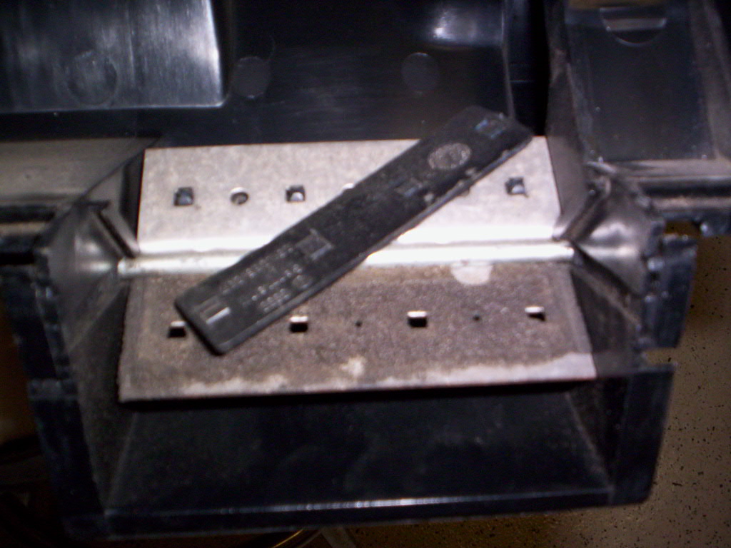

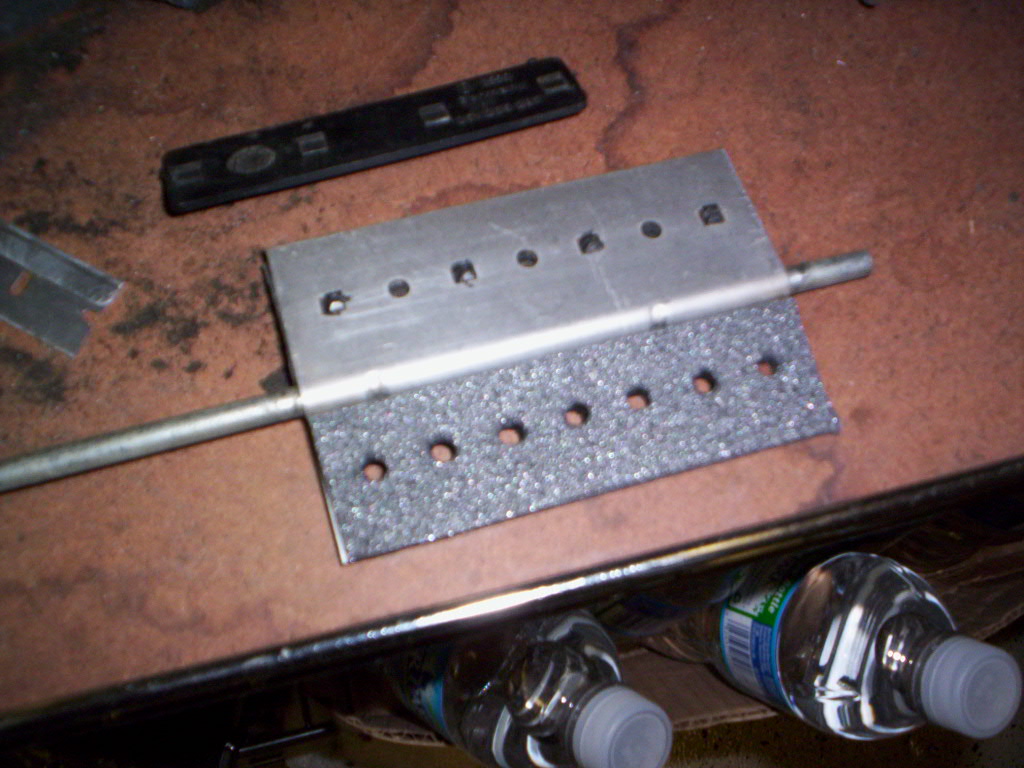

I just finished this project. Saturday I removed the dash and the heaterbox and cleaned it up, replaced the fan and the flapperfoam. Sunday I did another thing or two, then put it all back together. I have a few observations.
1) It is a lot easier the second time around.
2) You don’t have to remove the dash to replace the windshield squirters. You can wiggle them out, and replace them with new. (a heat gun is nice to make 20yr old plastic lines a little softer to slip the nozzles off/on)
3) The number of stereo installs that have lived in a 20yr dash leave a bit of wiring mess.
4) The tip of the shearbolts comes right off; right after you put your vice-grips away and realize you forgot the washers. Why did I use them again?
5) The heaterbox is a great hiding place for pennies, confetti, watch batteries, and little dash lightbulbs.
6) Replacing the “to-the-back” vent flap foam is a pain the butt, since you do them in place. I read that someone removed it, but I didn't want to hack up the box.
7) If you stick the foam on (2.5"x .25", made by 3M)******edit - it's 1.25" wide, oops***** without cutting the 6-8 holes for the retainers, a hot awl from the backside opening in the flap makes the cutest little holes, in the right place, too……
8 ) Are those dangly fresh-air flaps removeable?
9) I was “blown away” by the difference the new foam made. While the new fan is not any stronger, the new flapperfoam allows all of it to be focused on a single place. Defroster is like a hurricane compared to what it was before.

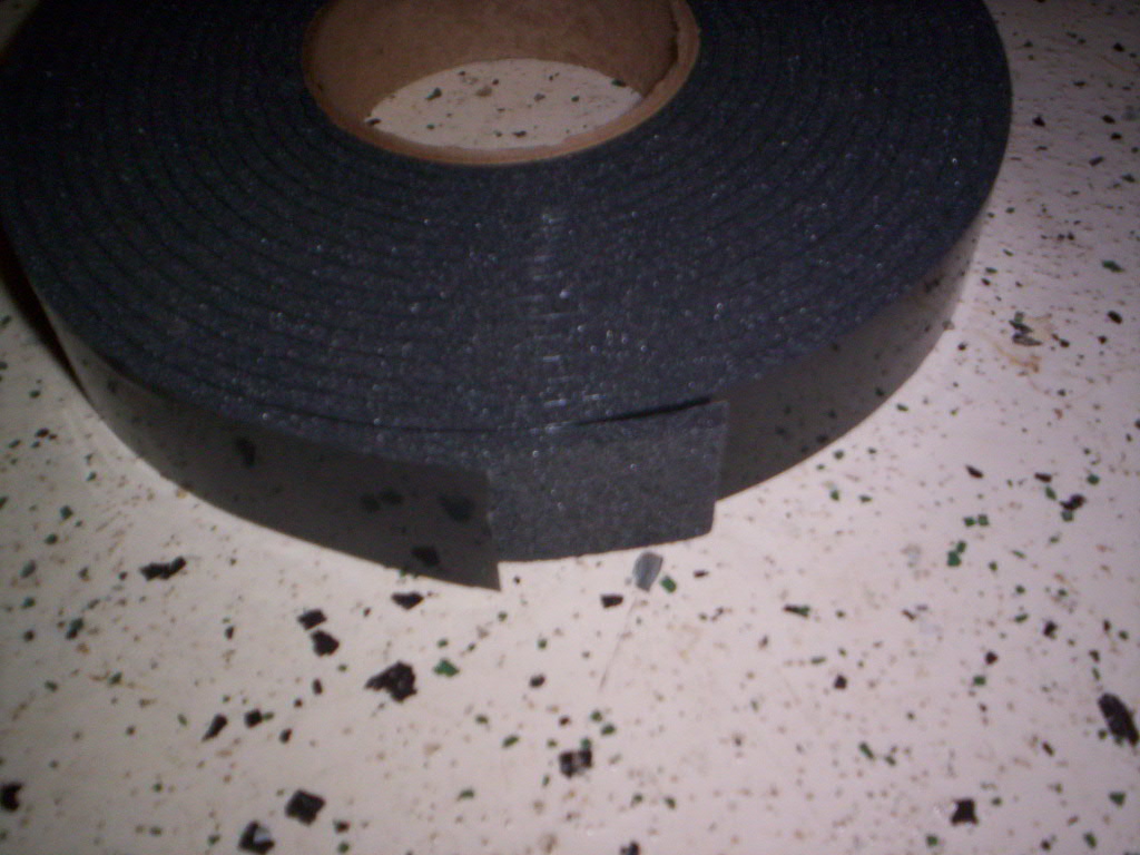

do you have a # for the 3M foam you used?
No, I sure dont.....sorry. I threw away the packaging... I bought the roll at Advanced Auto for about $12, and the instructions would have helped me attach a cab to a truck bed. The dimensions were 1.25" wide, and 0.25" thick. It was self-adhesive, and I had a plastic film on the other side that I had to peel off.
The 1.25" width was just about perfect.

Good info on the 3-M foam tape---
Here's another one of them jobs you don't wanna cut corner's on.
Do not buy the Ace is the place or the brand X sealing gasket material when your having a hard time locating the right stuff.
The adhesive on the back side of the cheap stuff is garbage and will not stick to the heater door's very long.
The 3-M foam tape will stay on the door's a long time without rolling off.

True, that stuff was sticky. Make a mistake, and you'll be scraping, sanding, and using googone. Even though this tape was clearly adhesive, I would have never trusted it alone without those retaining clip-plates.
***edit*** I stopped by the store on the way home and got the foam info.... as well as upload a few photos.
3M Pickup Camper Tape
Part # 03420
1 1/4"x 3/16"x 10 yards.
What's left of the factory foam.
Remove foam clip, I mean.... dust clip.
After sticking the tape to the flap, trimming it, and peeling the plastic off, I heated up the tip of an awl, and stuck it though from the other side...I actually threw this one from the other side of the garage. I was getting pretty good by the second set of flaps. Bullseye!
Once the smoke cleared, this is what the other side looked like... Neat, and no cutting or measuring involved. Just put the retainer back in.
