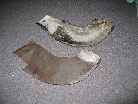

The splash pans were on bay and split busses. In addition to what their name implies, they stiffen the wrap around portion of the bumper.
There are slight differences between the two:
The one on the top is a Bay passenger side splash pan, and the one on the bottom is a Split passenger side splash pan. The mounting points are similiar. The Bay version has elongated holes allowing for adjustment. The Split version's side bracket is above and below the pan itself. Also notice the cutout for the bumper bracket is larger on the split version.
I am guessing they were factory installed.

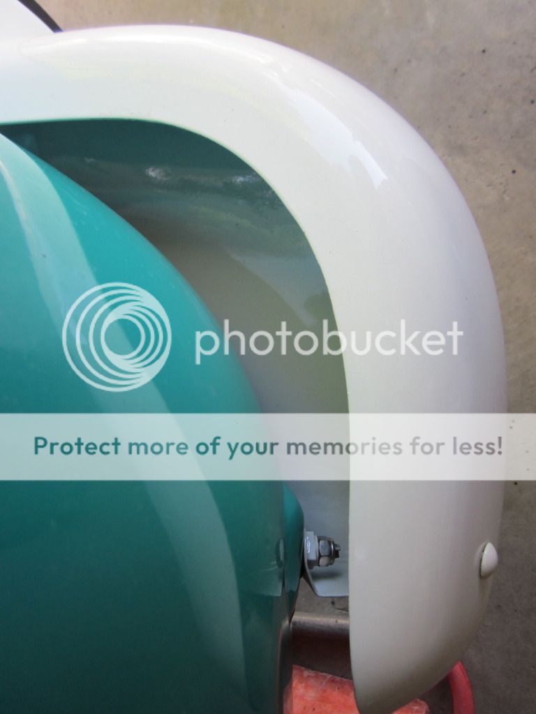

I ran mine without for 6 months till I found them in the parts pile from PO. bumper used to be a noodle. now you can stand on bumper. big difference, no longer vibrates up and down several inches at idle. I would not run without them, even if I had to fab some kind of brace. to me the bumper stiffening is more important than the splash guard feature.
