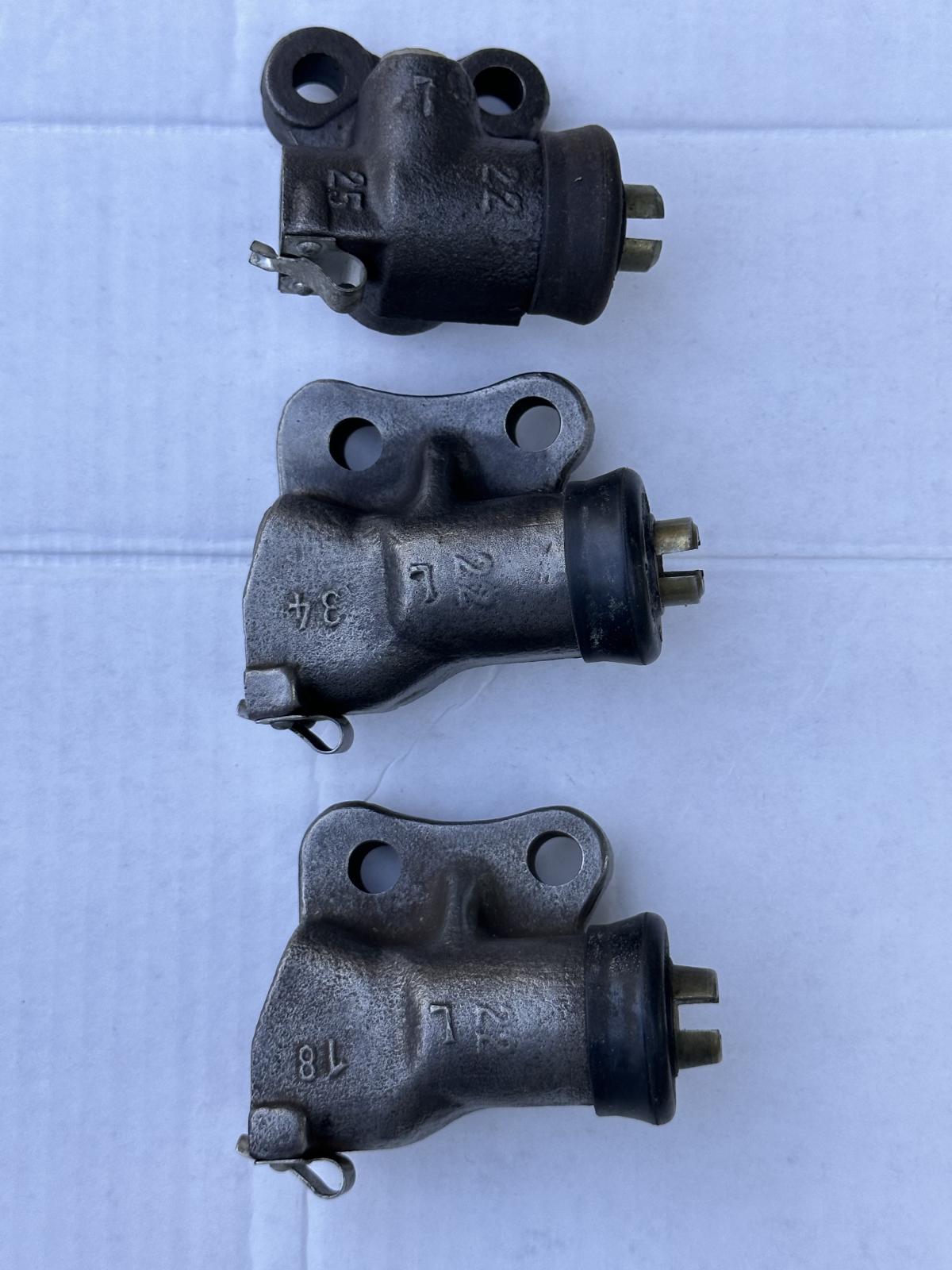

More info with photo representation:
ALLWAGONS wrote:
Here they are in order. Note the larger slot on cylinder C. This should be added to the sticky.
A
B
C
311 611 061A - Cylinder 22.2 - Front wheel brake, left.
Up to Chassis No. 27 849
Model: 361
From Chassis No. 27 850 up to 221 974
311 611 061B - Cylinder 22.2 - Front wheel brake, left.
From Chassis No. 222 975 up to 483 592
311 611 061C - Cylinder 22.2 - Front wheel brake, left.
From Chassis No. 315 000 001 up to 315 220 883
ALLWAGONS
Joined: June 03, 2000
Posts: 4621
ALLWAGONS is offline
PostPosted: Sat Sep 07, 2024 6:24 pm    Post subject: Re: Early Wheel Cylinders Reply with quote
Housings are almost identical, slot in cylinder increased
‘62-‘64 B 3.8 mm
‘65 C 5.3 mm
