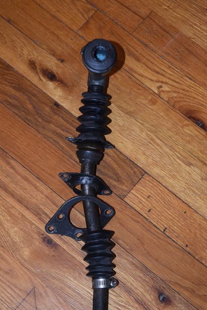

[img]
[/img]
Hi. I have removed the rod yesterday. comparing it to few other illustrations, it appears that i have installed the cups that holds the bushing on the wrong side. I think they should have installed on the other side.
Also, how is the position of the bend looks? Is the hump supposed to be horizontal like this? Thanks

PostPosted: Mon Apr 02, 2018 8:08 am    Post subject: Re: Where is my 2nd and 4th gear? Reply with quote
i took apart the rod and switched the location of the bushing and the 2 metal pieces to the other side of the hanger and now i have the 2nd and 4th gear. Thanks for the help.
