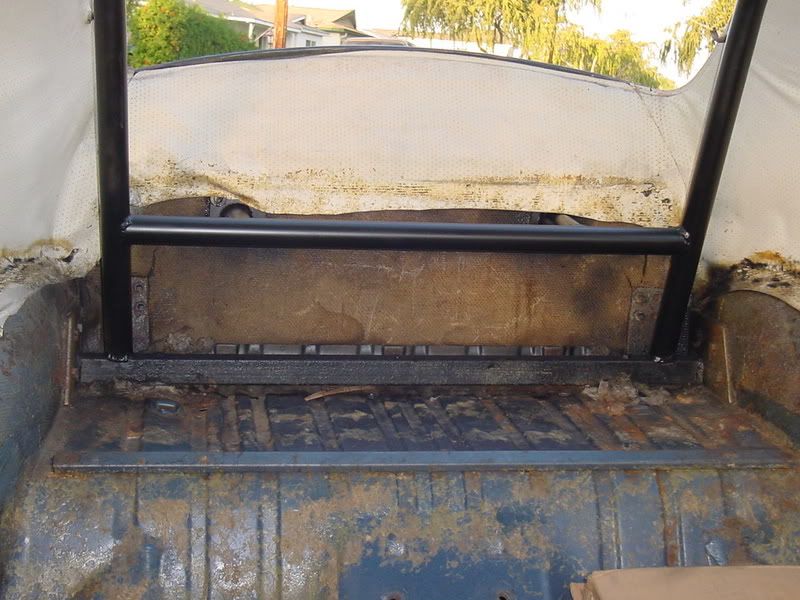

Is this one better or worse than the others?
Mine (I think) attaches to the framehorns on the bottom....I can't find a decent pic of it right now...
The top of mine:
Ties into the rear of my cage:
Look at my for sale ads. Cool
68 Baja on STFU
68 Baja on Samba

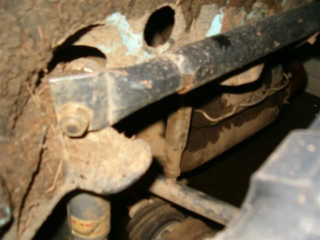

PostPosted: Fri Jan 11, 2008 11:19 am    Post subject: Reply with quote
Bottom

PostPosted: Fri Jan 11, 2008 12:02 pm    Post subject: Reply with quote
dude should have gotten the firewall mount one, these are hell to get on and off,
