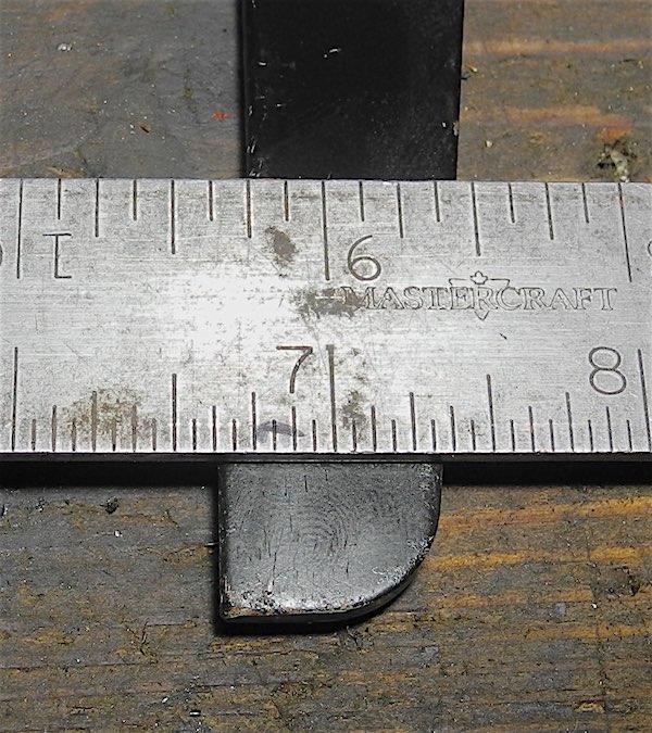

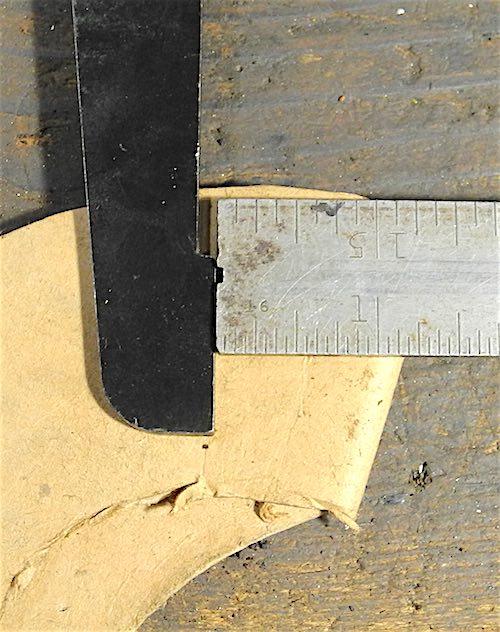

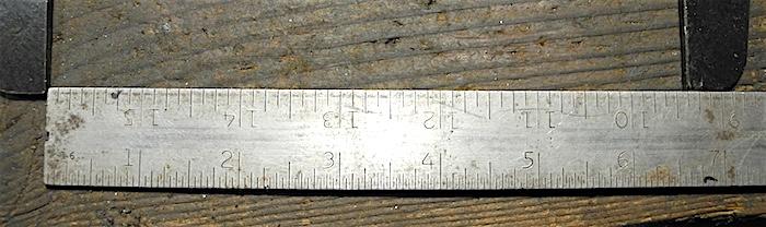

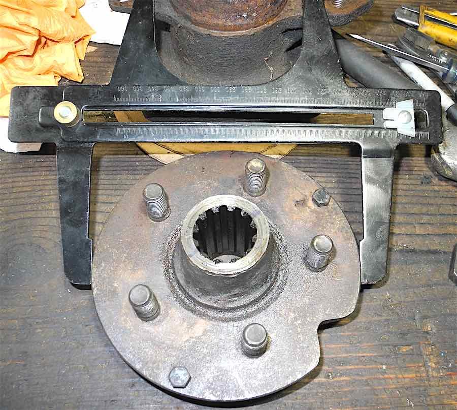

My regular callipers are too small. Don't know how accurate a measurement you need so I posted pics.
Callipers "tight" to hub, (shown resting on housing and supporting themselves at hub flange):
6 - 21/32"

Glad it helps Mark and it sounds like even if my measurement was off by 1/16" or so, it doesn't matter. Those callipers were stiff to adjust hence the "tight" measurement.
