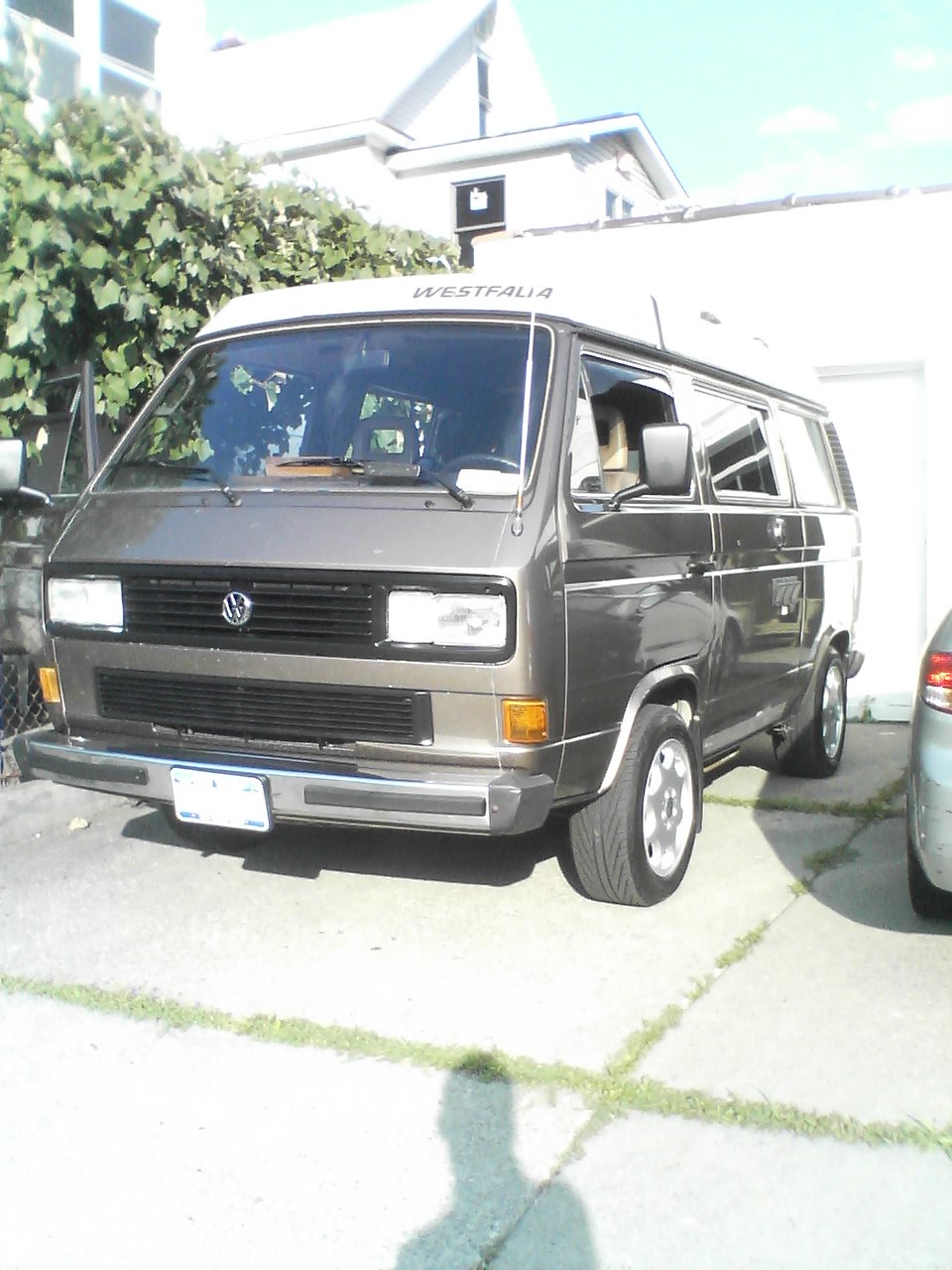

PostPosted: Mon Dec 17, 2007 3:00 pm    Post subject: Reply with quote
Here's a pic of the wheels.... I suppose I should have specified a tire when I got them, but Gowesty is obviously not dealing with snow! Wink
