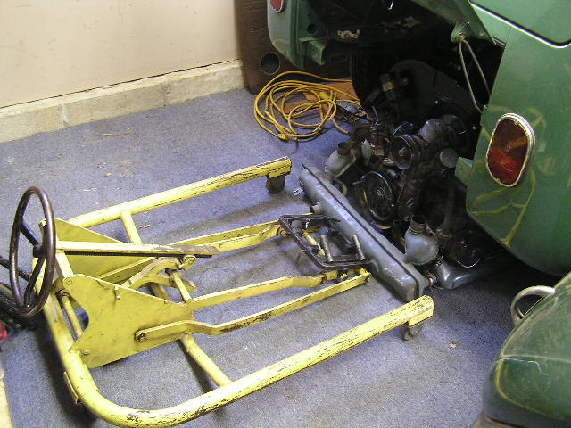

This thing rocks! I used it today for the first time. Definitely made installing an engine easier, allowing one to finely adjust the height with just one hand, while under the bus checking alignment of transmission bolts. I also used it to install a transmission, and even to raise a bus on two wheels just as a regular shop jack would.
I found a thread about these things in the bay window forum (http://www.thesamba.com/vw/forum/viewtopic.php?p=2981742#2981742), but no mention of it here so I thought I'd share.
In "locked" position.
Base released by two spring-loaded levers, very user-friendly.
Done!
Came with three adapters for early 36-40 hp, 1500-1600, and 1700-2000 aircooled engines. Nice to have in the shop.
Cris

Here is the low budget Harbor Freight version that I use:

The down falls of the Harbor Freight one is... The thing does not lock on to the case, the front wheels do not swivel, and the plate does not tilt.
Chris we got that for an anniversary gift to eachother way back and it was the best one yet. The only problem I have is I keep breaking the wheels. Do watch the ball on the crank wheel. I caught it just right and ripped a hole in my thumb.
Plus height adjustment might not be as precise? And will it last as long? Hmmm...the dealer lift really feels like it will work for another 40 years.

I like the Harbor Freight lift.
Wait for it to go on sale, as it does every two months or so.
I plan to make a tilt plate to fit between the arms, I'm just using two by fours and wedges now, but works pretty good.

I don't suppose it would be too difficult to fab something to lock to the engine on the China Freight lift.

Yes, the dealer lift is awesome. I love mine, so do my good VW friends here Laughing
I paid $150 for it from the same old closed shop I bought my '64 from.
I have the 40-hp and later engine clamp and the TypeIV adaptor. I wish I had the 36hp one instead, I'd actually use it instead of the type4 one which i'll probably never use.

Get lucky and stumble upon one. When I went to scope out the shop in Mississippi I bought the '64 from, it was in the shop itself with an engine on it. The owner showed me how it worked and I immediately asked "Is this for sale too?" He hesitated a bit, I could tell he didn't really want to get rid of it even though he'd closed shop a few years ago and said "for you, I guess it could be......$150" I didn't even haggle and said "SOLD!"
Best $150 I've ever spent for anything VW related. It cuts engine removal/installation time about in half for me.
