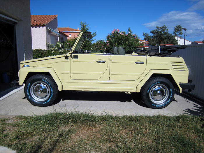

I have 205/75/15 and a little more power for this size:

sam_w
Joined: March 07, 2002
Posts: 1479
Location: Petaluma, CA
sam_w is offline
PostPosted: Fri Dec 28, 2007 6:36 am    Post subject: Reply with quote
Thanks, but is your spare the same size, and how does it fit under the hood? (205-75-15)

Chris181
Joined: April 05, 2004
Posts: 90
Location: French riviera
Chris181 is offline
PostPosted: Fri Dec 28, 2007 8:47 am    Post subject: Reply with quote
Oh yes Embarassed
Under the hood is 185/14, I think you can't fit larger.
