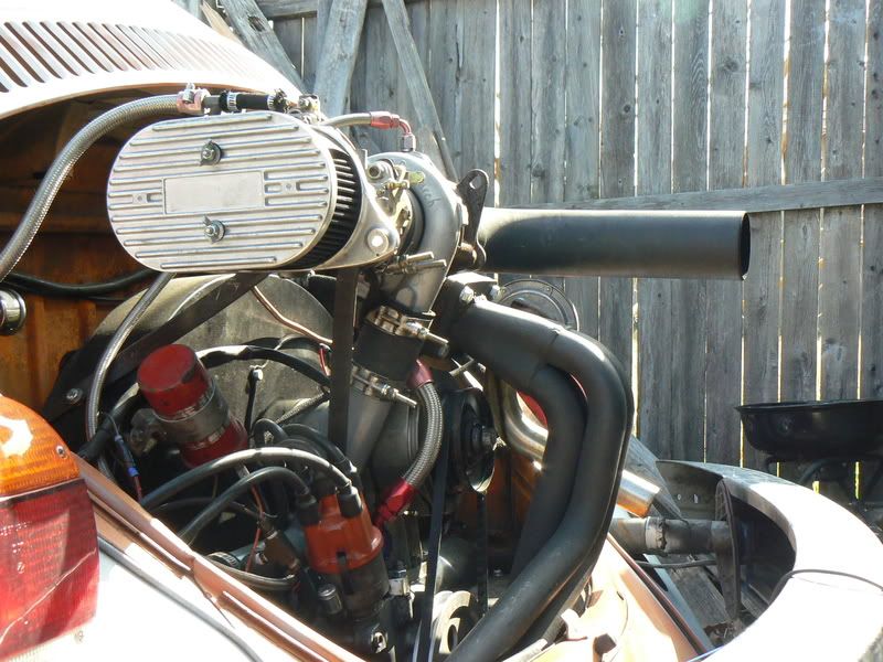

PostPosted: Thu Feb 14, 2008 7:46 am    Post subject: Reply with quote
If you're willing to lose the rear cooling tin, and possibly trim your apron a tad, draw through is what you're looking for. Based on your cam selection, I'm going to assume you have compression in the high 8 to low 9 to 1 range? You'll need to drop that to closer to 8:1 or lower for turbo use.

brownprimer wrote:
What is a couple of cams that might work well? I think my compression is at 8:1 but i will have it checked. Anything I need to do to my heads? They only have 4000 or 5000 miles on them so they are in good shape. My rear apron is fine for cutting up.
I run a draw through setup on a 1915, and did NOT have to cut the apron, or any part of the body to get the header to fit. Also, I am still running my rear tin. My engine builder trimmed the tin around the header, it's a perfect fit. As for cams, I am running a Engle TCS10 cam, but I'd recommend a TC20. Alot of turbo guys have ran the FK8 with great success though...
Here is a pic of my setup:
1974 Super Beetle-turbocharged 1915-mine
1974 Thing-dads

I think maybe a draw thru may work. I am going to call around to some junk yards in denver next week and see what I can come up with. Unless I find a workable used set up. I've heard that running a setup under the decklid can make the engine run to hot, is this true? The stealth look would be alot of fun. Yet the turbo sticking out the back a foot is awesome looking. So either way. Should I start pick gear ratio's after i get the turbo system? right now i have- 3.88r&p 3.20/1.84/1.48/1.04. i'm a little afraid that the 1st gear might be a bit tall
