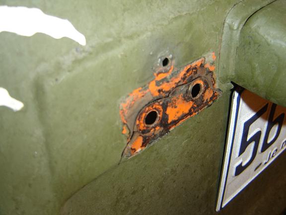

You need to remove some load from the decklid or cracks will appear...
Here is what I've found when I remove mine...

cut a backing plate outta steel and that will reinforce that and spread the load over a wider area for the underside.
