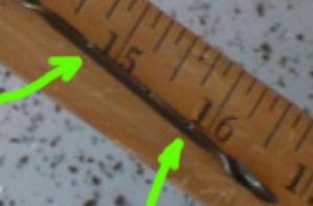

I added a third notch to my dipstick once I decided where it likes to be (arrows are factory notches).
I don't think there's any harm in filling to the top mark but it may tell you if that's too much (oily film on tailgate).
