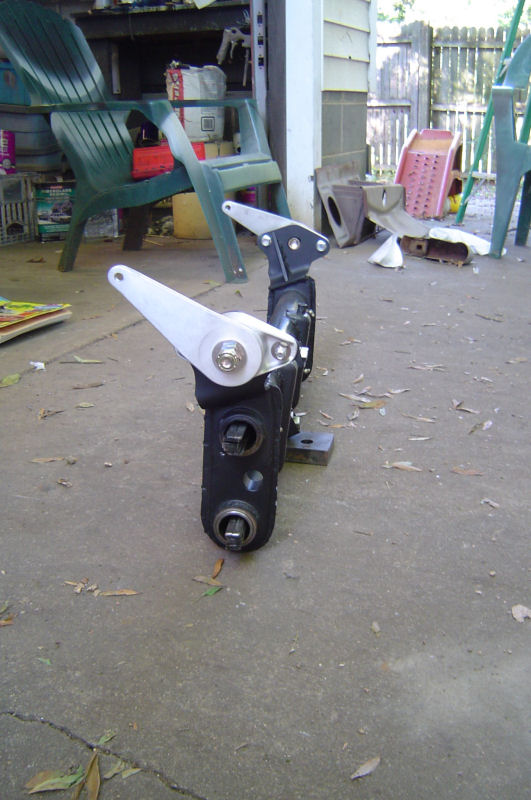

Danpa
Joined: August 21, 2007
Posts: 1311
Location: Valparaiso, in
Danpa is offline
PostPosted: Mon Feb 09, 2015 8:58 pm    Post subject: Reply with quote
The body is back off now, getting prepped for paint but, my 4" narrowed beam didn't even come close to touching.
This might be the reason though... Very Happy
Dan

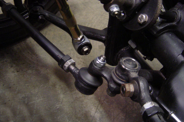

Danpa
Posts: 1311
Danpa is offline
PostPosted: Tue Feb 10, 2015 2:50 am    Post subject: Reply with quote
I made them at work. Pretty simple, some scrap stainless steel and a few pieces of heavy leather combined with the 3/8 black pipe for the links.
I admit, I have to shorten the levers a little, they barely come in contact with the tie rods when you turn the wheels at full lock.
Dan
vaughn bros.
Joined: October 13, 2003
Posts: 2398
Location: Hickory, NC
vaughn bros. is offline
PostPosted: Wed Apr 15, 2015 8:21 am    Post subject: Reply with quote
I dig your friction shock setup. I ran in to the same problems with the tie rods at full lock was too close to the "Push Rod". After fiddling with different length rods Laughing and adding my own stops that gave me just fractions more clearance, it all worked out.
