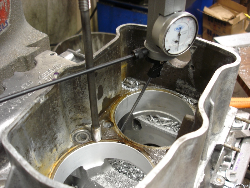

This month I will be starting to assemble a very special wasserboxer and I thought some of you might find some of it interesting. Last year I stumbled upon a NOS set of original Oettinger 2500E pistons and cylinders. I had always dreamed of owning one of these engines, so I wasted no time in snapping up the set. The pistons turned out to be forged Kolbenschmidt brand units with a very shallow and flat combustion chamber - very much like the factory 2.1 10,3:1 DJ code pistons. These have a lower compression ratio of 9.7:1.
They measure a full 98mm, so they are too large for bored out stock cylinder liners. I knew this at the time I purchased the set, and knew that the old Oettinger literature mentioned "special cylinders," so I was very interested to see the cylinders. My prediction was that they would be 4mm larger in diameter than stock with stock wall thickness, and would require case machining. Here's what arrived.
These cylinders are indeed nearly 4mm larger in diameter at the base than the stock wbx barrels. Here is an interesting comparison of one of these 2500E barrels next to a slightly overbored (.5mm) 2.1 barrel. 2500E is on the left. 2.1 at right.
As you can see the wall thickness is retained with the 2500E barrel. At the top, however, I was surprised to see that they had machined the larger 2500E barrel to the diameter of a standard wbx barrel. There is a little bit of room the wbx heads for a larger diameter cylinder, but they obviously wanted to keep the heads as a standard replacement part. These cylinders were manufactured for Oettinger by J Wisemann Company and, due to their small production run, are actually machined from iron cylinder liner tube rather than originating from a specialized casting as is the case with the standard wbx cylinders. Making them fit the case was obviously the next step. Actually things didn't progress in this order at all, but for the sake of this write-up I think the case mods should be described next.
There is an excellent VW engine builder and machinest located in Walla Walla, Washington. He is someone all wbx engine builders should be aquainted with. His name is Rocky Jennings and he is known for his case mods to wbx cases to make them work with large air-cooled cylinders. After talking with Rocky on the phone, I was very impressed with his depth of knowledge and his willingness to talk with me about my project. I sent a 2.1 wbx case to him for modifications.
Rocky actually trial bored an old case he had first to be sure he had the bore size correct. Here is another shot of the finished bores.
I don't have a shot of the inside of the case, but the amount of aluminum structure surrounding the cylinder bases is about perfect. Between that and the amount of material between the bore and the head stud holes, it looks like Oettinger took this cylinder base diameter out as far as it safely could go. Here is a shot of the cylinders test fitted. The fit is perfect. You can start to get a feel for just how big these 98mm bores are in this photo.

Looking at the pictures, it looks like the stud inserts are right up to the edge after machining the case. That would be my only concern to reliability. There appears to be enough surrounding material to hold the inserts snug. Should be a nice project when completed.

There's actually more material there than it appears. Rocky dressed the bores, so there is a bevel at the beginning of the bores that appear shiny and one dimensional in the photos. But, yes, this is about as far as you'd want to go.
