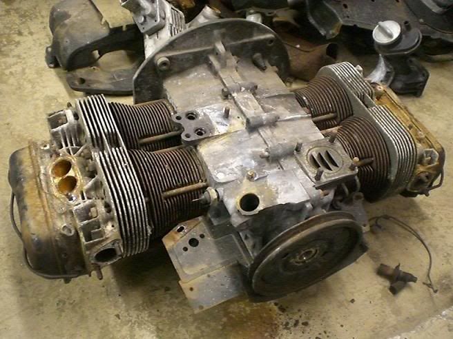

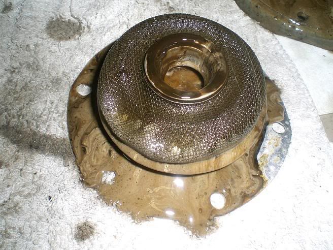

Here is an engine that I am working on that has some water in it. I think its definitely worth saving as it is a AS21...
This is one pic of an intake. The other side is the same.
Best case, the heads, pistons and cylinders will need to be replace with new parts.

PostPosted: Tue Jan 08, 2008 10:57 am    Post subject: Reply with quote
The primary thing you want to look at is that sump area. Even if it's been severly coroded, it can be fixed as long as the rest of the case is good.

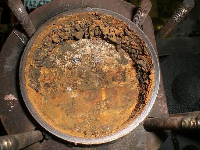

I bet whatever you find in the crankcase it WILL NOT be as bad as what i found in a junker engine I bought for the tinware. prepare yourselves...
Believe it or not, crankshaft was fine after a good clean! Bearing journals all still shiny. Alternator was good too. This on an engine that had sat outside for seven years. Heads good and in a damn worse state cosmetically than those pictured above. I shit you not.
good god that looks like not just shit but hammered shit

I've got a couple of engines from an outdoor lot and I am having a hell of a time getting them apart. I can get the heads off, but it seems that the rings and barrels are rusted together and I can't seem to get them apart or separated from the case. I haven't resorted to destructive measures yet. Any suggestions? The engines were free, I am just hoping for some core parts.
I had exactly the same problem with the horror story pictured above. In the end I had to resort to a large sledge-hammer (sorry, uk term). The barrels disintegrated pretty quickly.

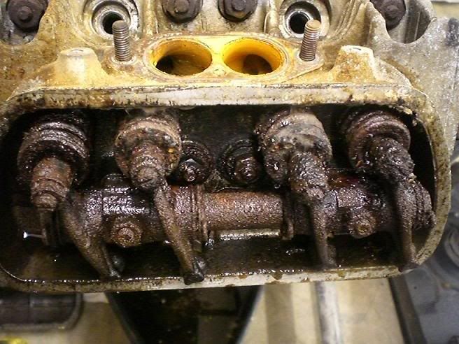

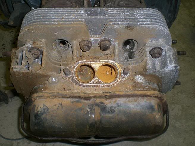

PostPosted: Wed Jan 09, 2008 8:29 pm    Post subject: Reply with quote
The same engine above revealed these lovely pix as well...
Inside should be interesting...
