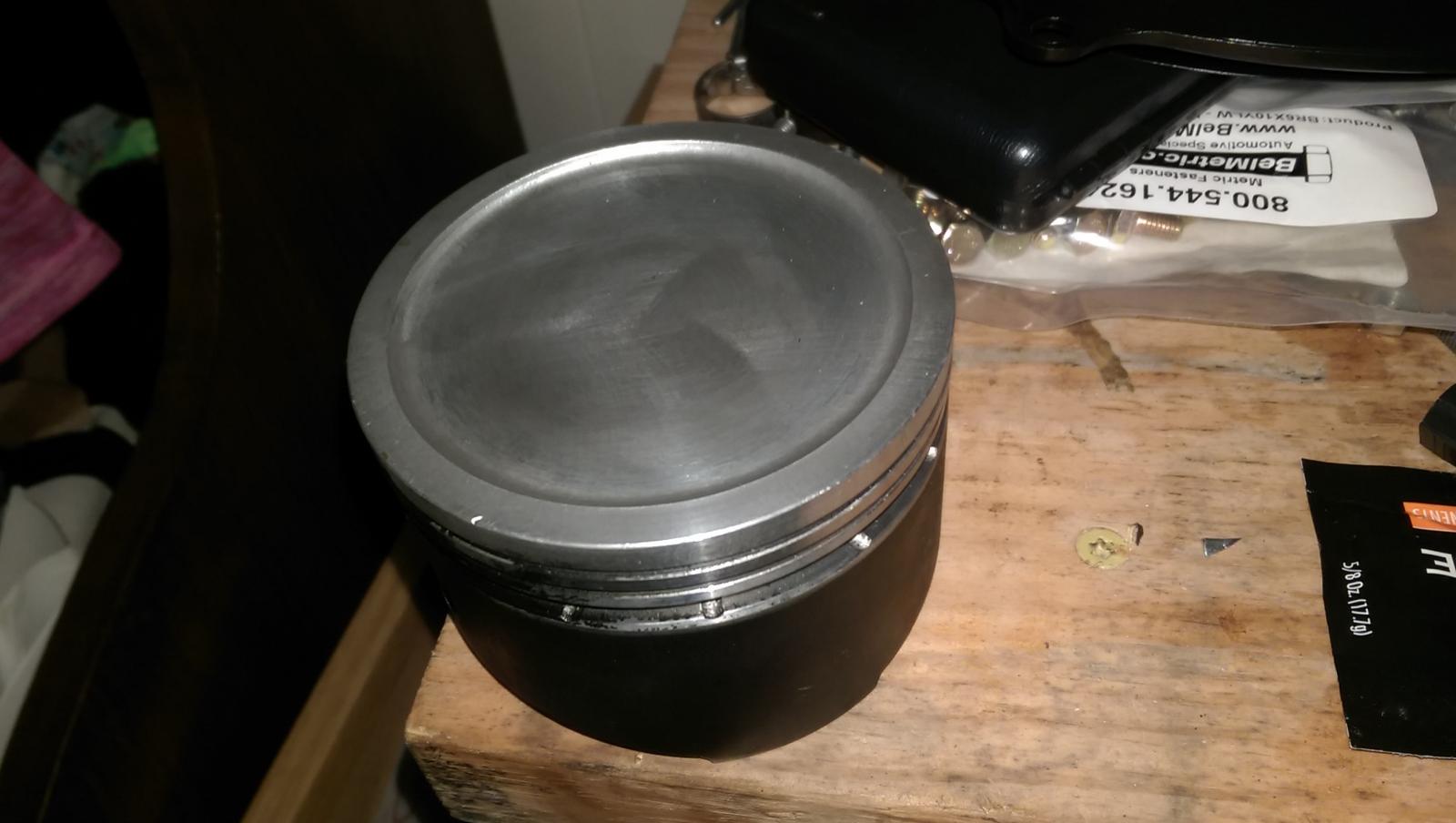

It contains a DPR 84mm crank with chevy rod journals, balanced along with the flywheel, which is wedgemated. It has 5.5 Scat H-beam rods. The cam and lifters are from Jason at Paradise Motorsports. The cam is not too wild, just a little bit bigger than a 110. I'm using AA 40mm intake 35.5mm exhaust heads that I ported myself. I also had a friend unshroud the valves. I'm using EMPI 1.25 ratio rockers.
The pistons and cylinders are cima, forged 90.5 'b' pistons. I'm using Grant chrome top rings and totalseal seconds.

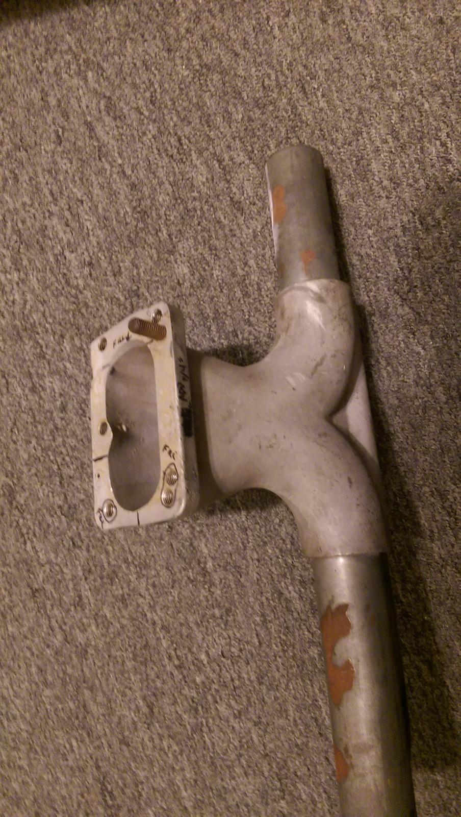

Intake manifold is an old holly bug spray that I will have to modify a little. It's really close though.

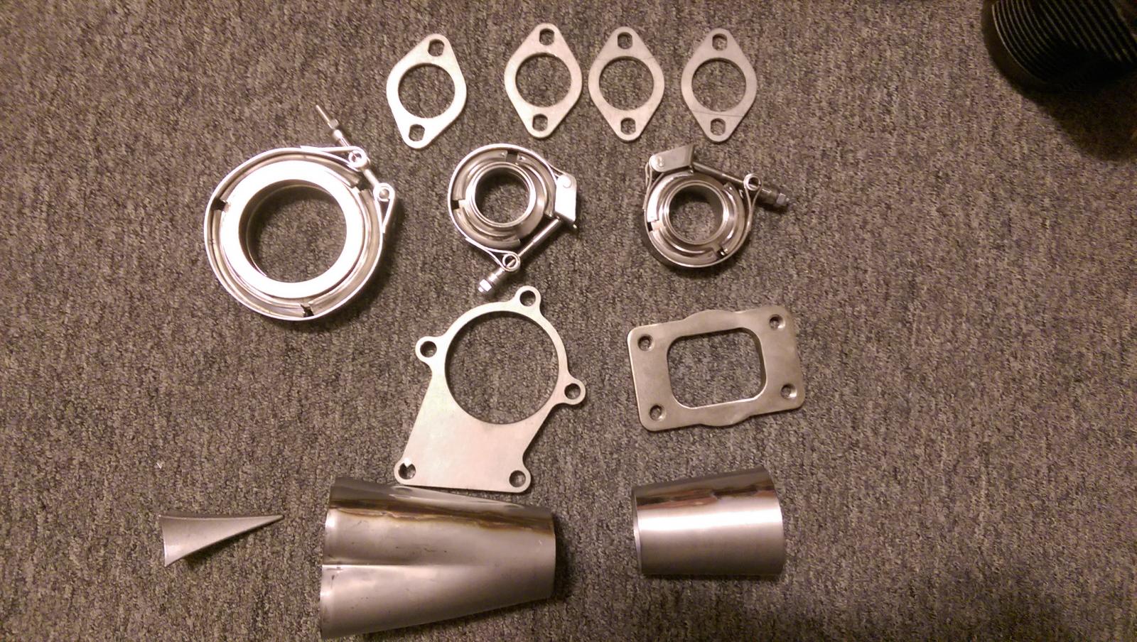

I'm building the exhaust myself. It's gonna be 100% stainless steel. I'm going to take it forward and have it exit in front of the passenger rear tire. I want this engine quiet hence the length. Here are some of the bits:
The VW flanges are SS from aerovee. The vbands are vibrant performance. The little ones will be where the j pipes meet the collector. The t3/t4 flanges I got on amazon. The merge kit is from cone engineering. I have pipes and a magnaflow muffler and a vibrant super quiet resonator too.
