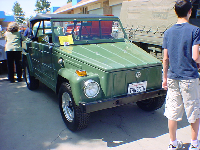

According to the '74 VW Color's brochure here are the only colors...
I wonder if this isn't more the color and sheen of the "Avocado" green...
I believe there was only single stage paint at that time and the finish was a satin or "semi gloss". Here are some other paint related links on the subjet...

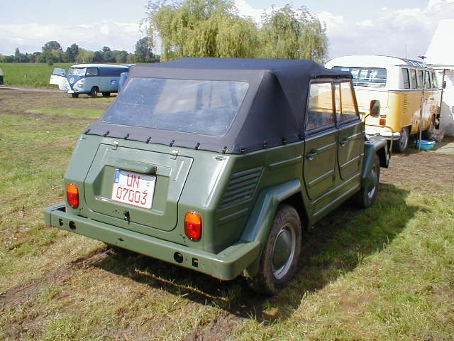

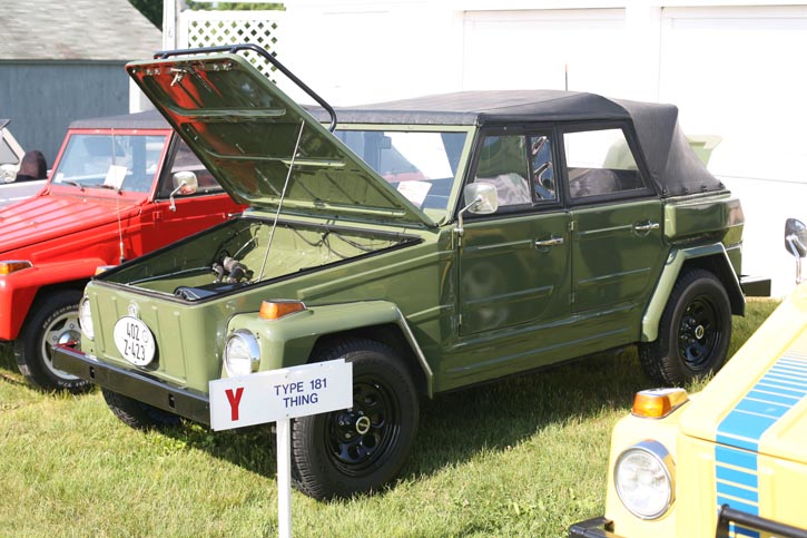

Actually this one looks real good also. Courtesy of the gallery...
Not "Super High Gloss" like some of the base coat / clear coat paint jobs I've seen.

that is the shine i am looking for. do you know if the first photo is what a 74 thing should look like. the one in the photo looks older

No, I'm sure the first photo is older than a '74. It's a euro model (note the tail lights) w/ no side muffs. I don't know anything about the car...again courtsey of the gallery. I just thought it had the right look - color - sheen - etc.
