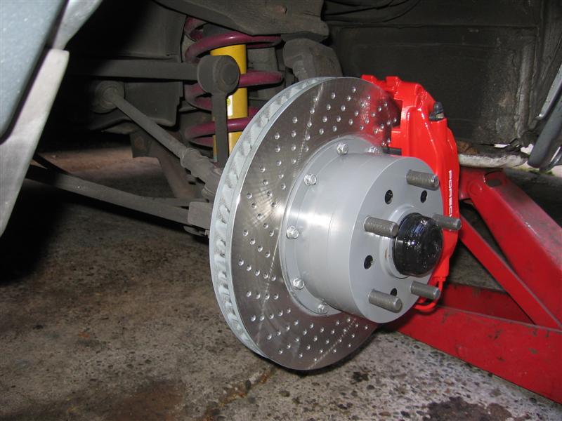

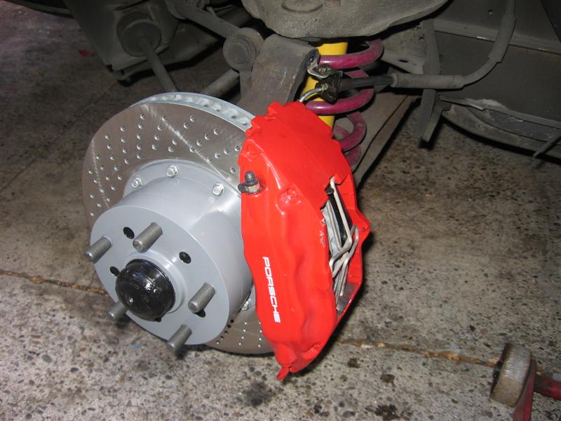

Option #3, my kit. Porsche 993TT calipers, rotors. (big reds).
I replace the entire hub assy with mine. The bolt pattern is changed to Porsche 5x130mm. Min wheel size = 17" et 50
I have 2 kits in stock.

Tristar Eric wrote:
Wow, I'd have a hard time covering up those beauties with wheels, seems like a shame....
