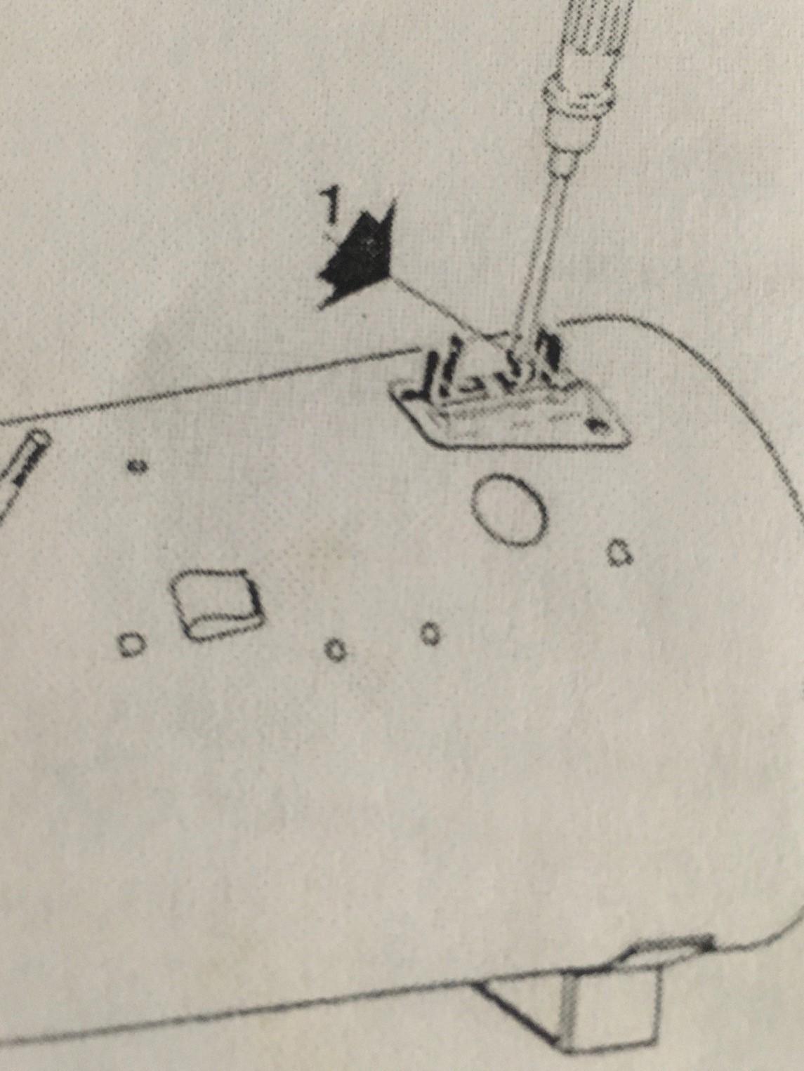

Hi guys, I need a Safety Thermal Cutout switch for my heater. Anyone know of a supplier ?[img]
[/img]
