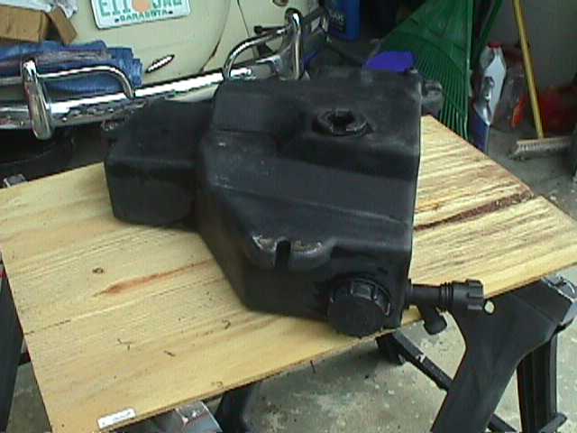

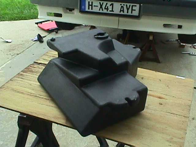

Hi,
Does anybody have a gray water tank?
This one should go under the drivers side wheel well,I think?
If you have one could you show some pic's to help me out. I have one that is from Germany and I want to fit it. I am not sure how it hooks up.
Any help would be great.

The adventurewagen was stock with a water tank and they pop up from time to time used. They are a bit on the large side though but that's because aw's hold a lot more water then westies. Not sure if something like this would work?
You can see the drain cap at the end hanging.

Any chance you have pics of how those install brackets fit up? I've got one of these tanks sitting on a shelf in my garage. If I had a good idea of the best way to mount it, I'd tackle fabricating the needed parts. From the photo of the install kit it doesn't look that hard to make a few L-brackets and etc. from Home Depot work.
nothing on file, lemme try and get a shot of what I can tommorow if the weather is clear.
