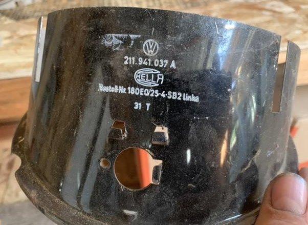

1950 and earlier parts are stamped with a MM DD Y sequence where MM=Month, DD=Day, Y is a letter indicating the year.
1951 and later parts are stamped with a sequence consisting of 1 alpha character and 2 numeric digits.
The alpha character is the year where:
1949=H*, 1950=I*, 1951=J, 1952=K, 1953=L, 1954=M, 1955=N, 1956=P, 1957=S, 1958=T, 1959=U, 1960=V, 1961=W, 1962=X, 1963=Z, 1964=A, 1965-B, 1966=C, 1967=D
O, Q, R, and Y were not used.
* H & I are unverified
The numeric characters are the week of the year.
Examples:
M 05 would be the 5th week of 1954.
07 26 H would be the 26th of July, 1949.
31 T would be the 31st week of 1958

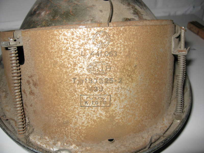

I have a Hella headlight assembly that is the early style with the date stamp "K". I think this corresponds to 1952 and would fit with the alpha sequence for Hella. |

Here´s a Hella headlight with 43J date code. VW logo at 18.00 hrs in the lense and Hella logo 18.00 in the chrome rim.
IMHO evidence enough that 1951 could be added to the list.
Looking at this unit the Hella example is the wrong way around:
"Example: M 05 would be the 5th week of 1954"
Should read 05 M = ....
