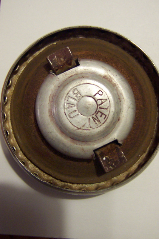

I started collecting gas caps and need info...mainly for 55 - 67...
What is the difference between PATENT BLAU and LICENZ BLAU?
From gallery:
And
What about P. A. G. LICENZ BLAU. I have assumptions but didn't want to post them.
