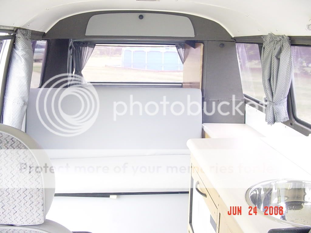

Good morning, can you post your pics of your non-stock headliners. I am looking to see what busses look like that have headliners that the owner did themselves.

Here's a picture of the Landmark headliner. I know, it looks like the padding from an insane asylum...

These are the panels the Po of my bus made. It is a thin foam lining and blue material over the stock wood. I have not installed them yet. I am going to put B-quiet sound deadener on the roof and then install them.
I actually like them, It matches the rest of my bus, and I think these combined with the sound b-quiet on the roof it will reduce the road noise in the bus.

I covered masonite paneling with vinyl and screwed to wood stringers.

My bus has a sunroof so I screwed the stringers to the inner panel (where the metal sunroof used to go) in the back. In the front I screwed the stringers to the cross support beam. In a non-sunroof bus you could screw wooden stringers to these support beams from front to back.

I was going to go with wood, but instead I went with the stuff that is used in bathrooms. Its a glossy white on one side and made of particle board. A BITCH to hang up because its so still and thicker, but I was able to manage!

It's wood, but it is cool....Did this to my 70 deluxe. Ripped the old nasty vinyl out and in went a baltic birch. See link for a thread on it and my gallery for more pics.

Mine is 5mm PVC sheeeting.
This material is synthetic, available in many colors and will never de-laminate or curl from moisture. Great for door and kick panels as well.

I used 1/8" Masonite and painted it gloss white. Screwed to bows & sides using pan head screws with decorative cup washers.
Can't see a lot of it in this pic, but you get the idea. Goes well with the rest of the interior - trying to keep it bright & fresh looking . . .

Since starting this thread in March, I redid my headliner, door panels etc in felt. Here are some pics of the headliner, door panel and speaker compartment that I added. The felt is durable and glues easily to whatever you want to put it on. It is also as thick as the vinyl headliner so you can fold it over the windor channel lip when installing the new rubber seals...
In the pic of the door panel, I used a piece of Lexan to protect the material if someone so happened to spill one of their soda's onto it.
Here are some before / after pics:

The reason I installed PVC is because I use my Westy extensively for camping. The original paneling was de-laminating and the door cards were warped like most others. When one or two sleep overnight inside the moisture builds up, especially overnight in cold weather with windows all closed tightly and this material is not effected. As well, if doors are opened in rainy weather the panels are waterproof so there are no worries if they get wet. Nothing to cover or coat with the plastic either, just cut it out and attach.
