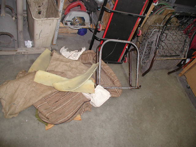

Some will rejoice that I am finally taking the "70s college porch couch" fabric out of my '50 11G. I was surprised to find a wooden strip inside the lower seatback to which the fabric was stapled. I don't recall finding this on my '57 when I redid one seat back. I do recall the tube running across with the slit along its length.
Is this original?
I can't imagine someone pressing a wooden strip in there.
Interesting taking that old upholstery off. It was done in Sweden, and as I have always said, it was done very well. The original horsehair pads are there, but bolstered a bit with some foam and jute-type padding. Burlap bags over the springs, and all stitched together with some sturdy twine. LOTS of it...
I have a West Coast Classics interior in the basement that I will be putting in the car.
Anyone seen that wood in a split seat before???

I have never seen any wood inside a vw seat at least from 46 to 85.
That wood strip looks added to me.

There should be a piece of cardboard knitted to fabric. That cardboard is pushed inside the pipe chink. Then pipe is prised so that fabric with cardboard is kept tight. I try ti find some pictures.

I dont remember finding any wood before either. But I can see that it was quite a logical idea for the person retrimming the seats at the time, especially as that lower rear bar is always weak if not torn away at the ends, have rewelded a couple there before.

Yeah, that is what I remember from my '57. I'm not surprised at this. This car has been full of "interesting re-engineering" since I got it.

Here a picture of split seat and the cardboard.

Just like the interior that came in your car, that piece of wood is CUSTOM Wink . I'll miss that interior.
Lenny's stuff has the strip of cardboard, but you may still have to make some adjustments to get it to fit properly.

That is an old repair from any old daddy.
If you have any question about seats ask ME
I am a sattler in german i work in an upholsteryshop.

I have met those grandfather repairs in my old vws many times. Sometimes very strange things. For example some was build a new woody window lifter, it's quite touch Very Happy
